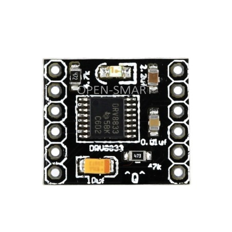

Bad
The data sheet supplied is for the drv8833 chip not the board itself. It is indeed the manufacturer’s data sheet but in context of the board not useful. The part turns out to be a clone of the Polulu part listed in the reply post, but it took me quite a while (although I remembered making it and knew it likely existed, I didn’t remember what it was called and it took me a while to find it.) A web site that sells the board itself (probably the website they bought the board from) would be the useful data there. That is likely to have the connections and the size of the board, and if not at least enough information to search for other sites that do have the necessary information.
This is a good example. It includes images of the board (although they are redundant given there is a link to the manufacture’s site which has the images as well as all the necessary data.) The ideal solution would be to get the link to the manufacturer’s web site as it contains all the necessary information. Unfortunately that isn’t always the case (which may only become obvious when you try and make the part.

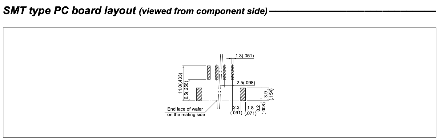

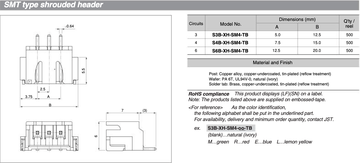

Good:
Not much. Little indication of part number (although they are there in the images) no data sheet and a search for the specified model number on the JST site doesn’t come up with an SMD connector as pictured but rather a different connector. I had missed answering this post so have replied requesting correct data.

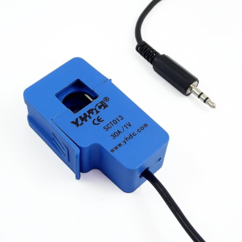

Bad:
Tilted picture of the part with no data as to connections (other then a 3 pin phone jack.) A google search for “Fritzing part current transformer” turned up several hits and there has been no further posts so that may or may not have helped.
