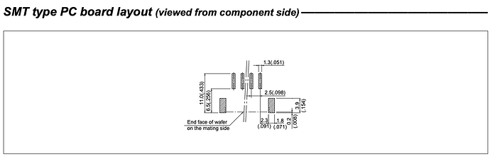

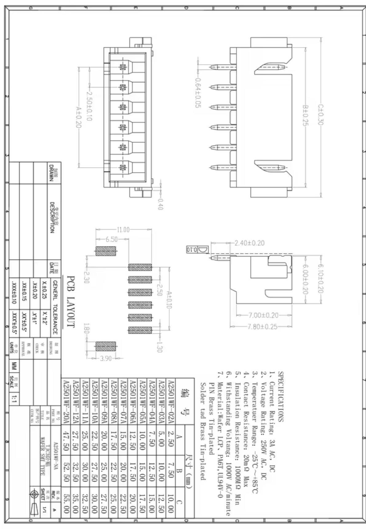

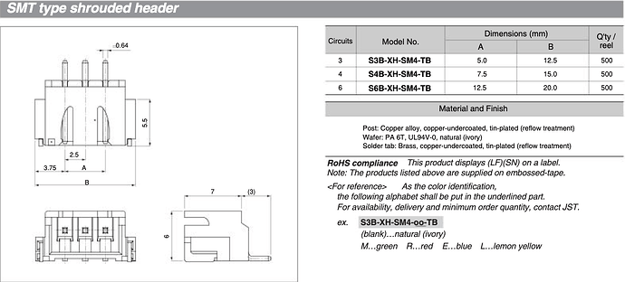

Sorry for the late reply, I saw this and thought I had answered. There isn’t enough information here to do anything with. We would need a link to the data sheets (not pictures as supplied) for the connectors (all the connectors, there are only 3 4 and 6 pin connectors here.) As well a google search of the listed part number comes up with a non SMD connector.

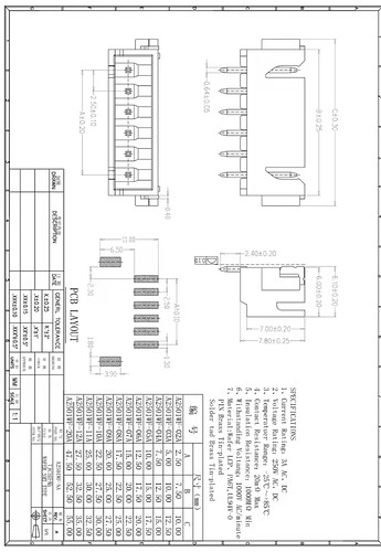

Thanks for coming back to this Topic! I don’t know much about these parts. Its a JST XH Horizontal 2.54mm Connector. I need this layout with 4, 6 & 8 connections. In fact, I only need the footprints for a circuit board. Here’s a full Data Sheet.
OK here is the first part. It would be a good bet to print the pcb footprint out at 1:1 scale (the default) and compare it to a real part to make sure it is correct.
The 2pin part is in fact incorrect and has been replaced. If you by chance have downloaded and installed it you will need to delete the current part from your mine parts bin, then shut down Fritizing answering yes to save part and yes to save parts bins (you can answer no to save sketch) to really delete the part which deleting it unfortunately doesn’t. Here is the complete set of the requested parts hopefully correct although you need to still check each against a real part to be sure!
