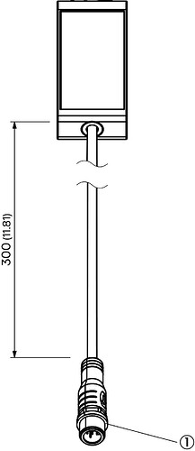

This picture shows the part from above, so that is easy to see were connectors should go, and which diameter they have.

Although this is a M12 5 Pin connector, just need routing to 4 pins: 1 (L+), 2 (Q2), 3(-M), 4(Q1).
