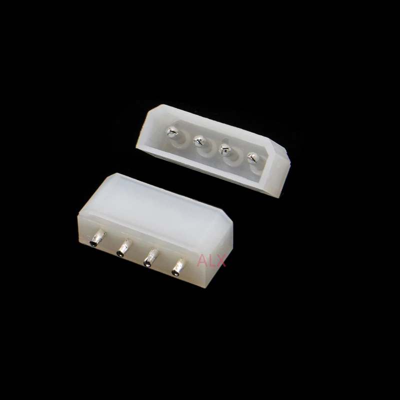

hi,
part 1
part 2
https://www.molex.com/en-us/products/part-detail/1726750613
part 3
https://www.molex.com/en-us/products/part-detail/353180620
Thanks
hi,
part 1
part 2
part 3
Thanks
Already there in core parts:
drag in a header, change it to molex in Inspector and set the pitch to 5.08mm.
Molex switches cannot be changed to two Rows
And how do I change to the following components or you can prepare?
part 2
part 3
In general if you only need a few parts it is easier if I make them for you. If you are going to need lots of parts it will be necessary to learn parts making (which is quite difficult.) These two tutorials on making parts apply to current Fritzing versions:
In this case for only two parts I made them:
molex-353180620.fzpz (4.2 KB)
molex-1726750613.fzpz (4.1 KB)
Note the hole size on the two parts are radically different: 0.055in for one and 0.070 for the other, but that is what the datasheet calls for so is presumably correct.
