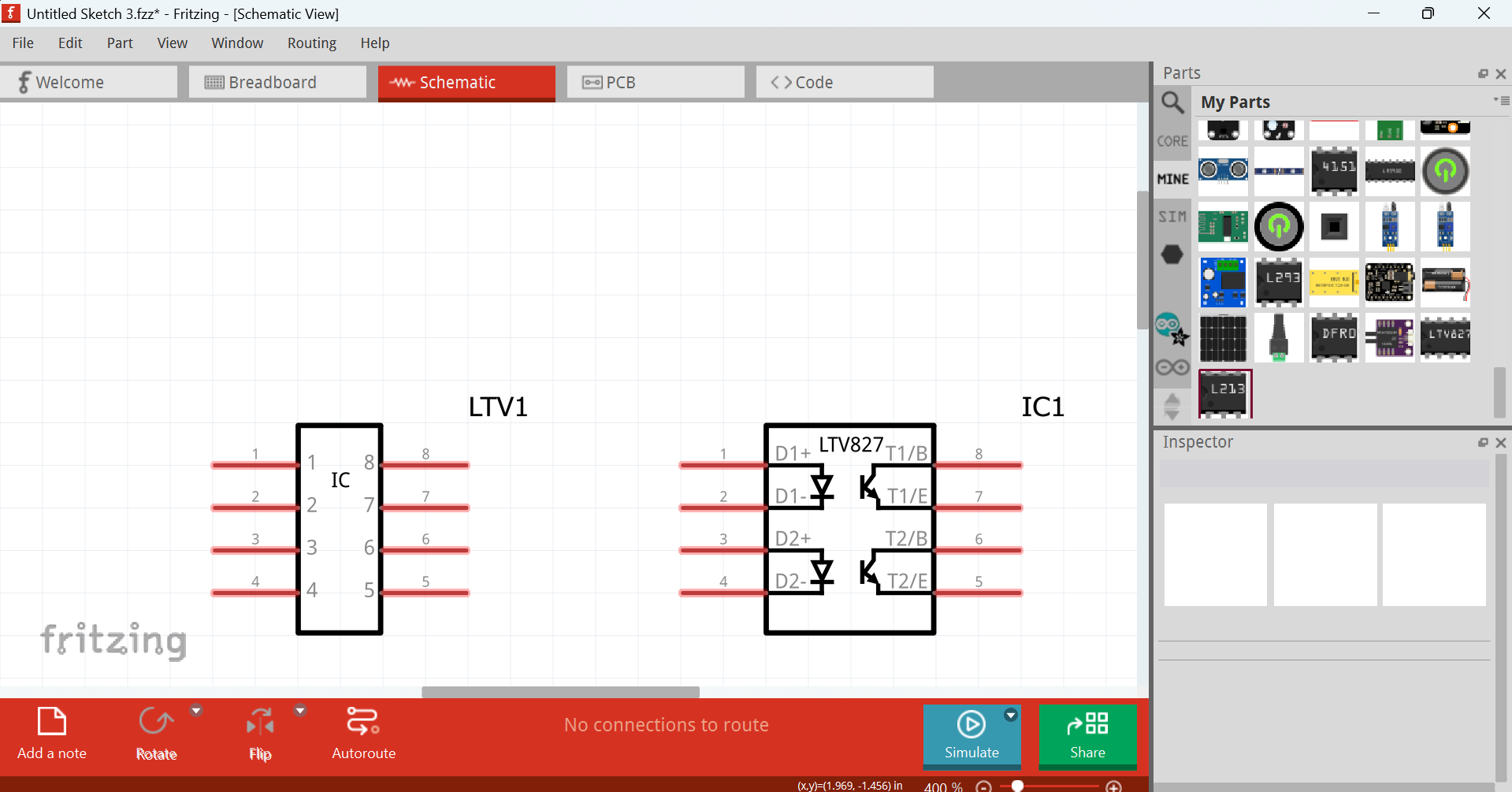

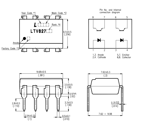

If you want the THT you can follow the procedure to make one here
I tried to do something but I’m not sure about the dimensions and I don’t know how to modify the schematic…
L2135 LTV827.fzpz (5.6 KB)
Never mind, Here is my version
LTV827 Optocoupler.fzpz (8.0 KB)

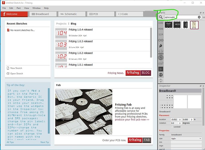

A google search of the form “fritzing part optocoupler” turns up a variety of already made parts. One of them may do what you want and have a schematic. I think there are some in core parts but no duals.
@SukaBlyatdu59 Did you look at my tutorial?
Your part has some issues
Comparing yours and mine, you have to change the schematic labels, pin labels, and part labels (from LTV to IC)
All above changes are covered in my turorial

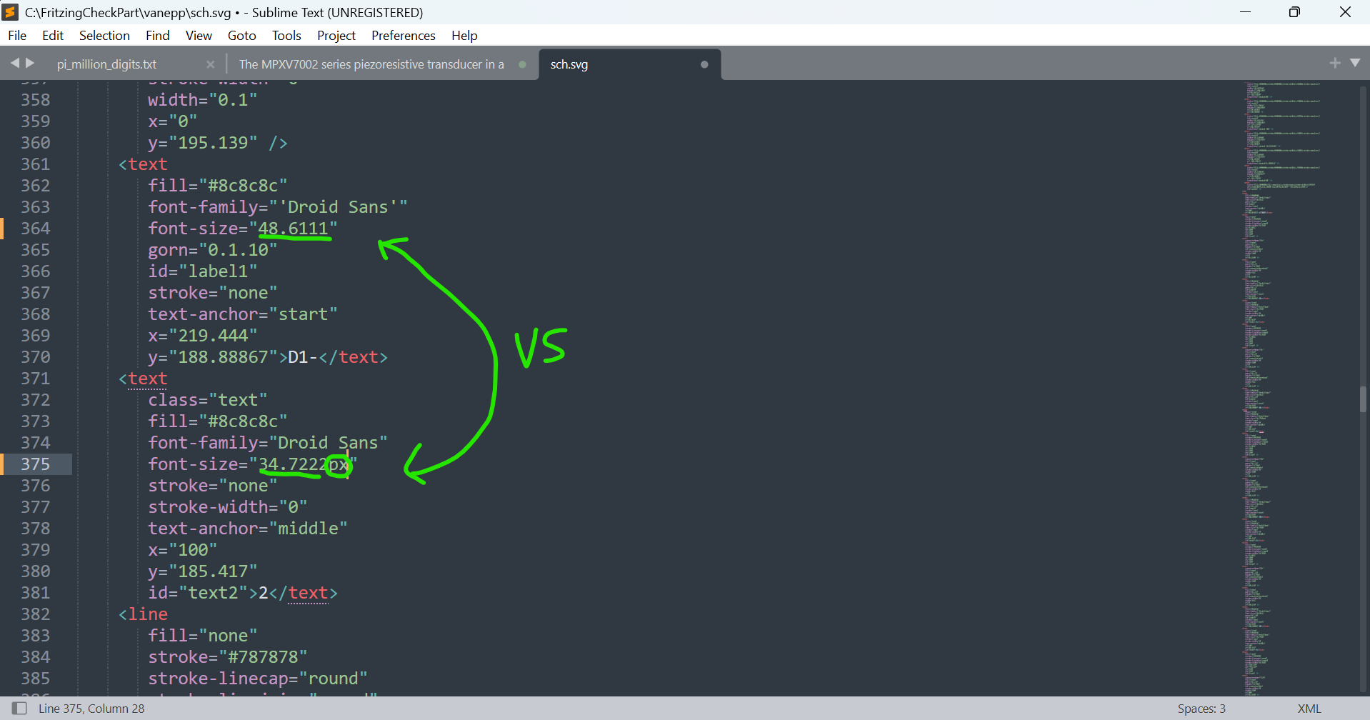

Be aware that part making is complex and tends to bite without warning. The svg editors (Inkscape and friends) do things that Fritzing objects to which can cause problems. You are best to run parts through FritzingCheckPart.py which will check and correct many common errors. You can find it in this tutorial on part making:
