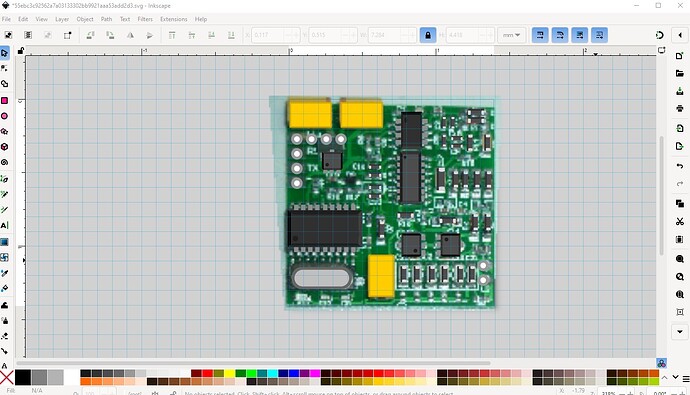

which is slightly rotated and warped. Imported the jpeg in to Inkscape and rotated it and then used the Raster perspective extension to convert it to a flat image like this (original in red converted in green)
then scaled the result to match your svg image
which gives me the placement of components on the board. Then pasted the various components in to the svg overlaying the components on the image.
at the end of that breadboard looks like this (with the image at the back)

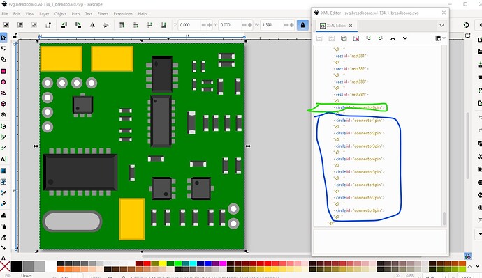

The connectors are grouped at the bottom of the svg (which allows me to automatically renumber them with a script which I did here.)
