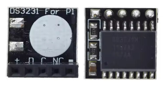

RTC DS3231 for Raspberry Pi (fixed part below)
Alternative part with akku
ds3231
RTC DS3231.fzpz (34.5 KB)
This part is usable with breadboard, but not in circuit diagram and layout.
Please rework. Thx
Thanks for feedback @Alex_F Ill check on tthe part
@Alex_F @codeflsgruen
The fixed part
Here’s how I fixed it
Hi Raptor7762,
thx a lot, now it works.
But there’s a little mistake - the pins aren’t named correctly.
You named the pins “SDA” and “SCL” as “D” and “C”.
Please correct it.
Thx
@Alex_F In the site and many otthers, it’s written as D and C
