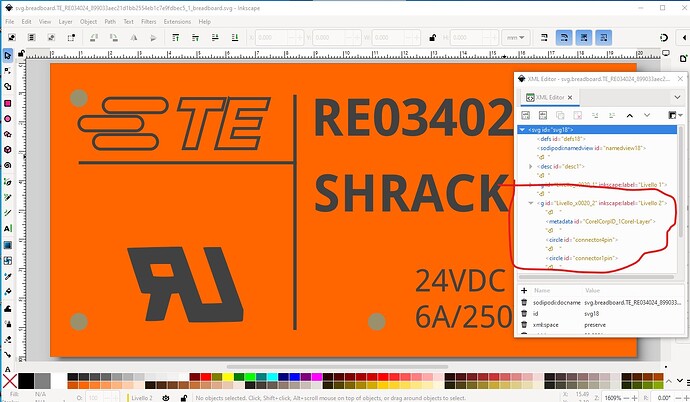

hello, This is my first part created, I couldn’t find anything similar and I tried to make it.
I left the metadata generic, even if the part drawn is specifically a TE connectivity RE034024 (coil 24VDC, 6A 250V)

Over all a good part but a few problems. This tutorial on parts making may help if you haven’t seen it:
Starting in pcb, you are missing the copper1 group making this a single layer part (and thus no hole will be drilled for the pins!)
It needs to look like this to work

Then the layerIds are missing in both breadboard and schematic. This will cause the part to not export as an image in Fritzing.
to fix it group the entire svg and name the group breadboard.
the same for schematic except the layerId is schematic

Which will replace the part1 label with RY1 indicating a relay. All of these changes are included in this corrected part.
RELAY SPST form A-fixed.fzpz (21.8 KB)
because I didn’t change the moduleId you will need to delete the current part from your mine parts bin, then shutdown Fritzing answering yes to the save new part and save parts bin prompts then restarting Fritzing before it will let you load the new part.
