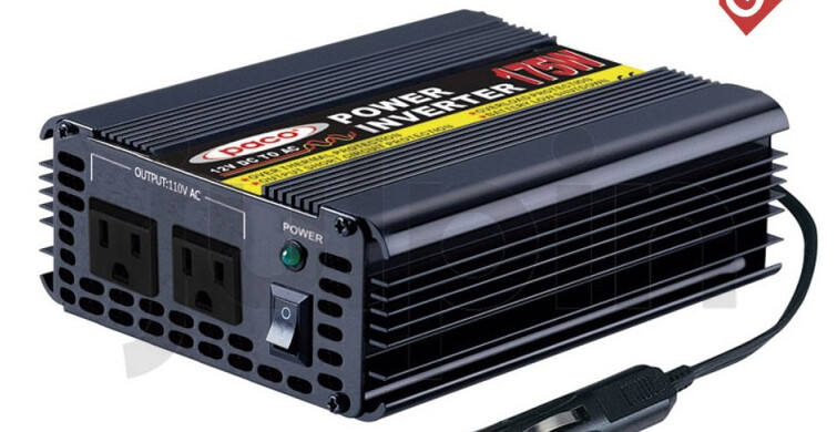

I need help creating a simple, generic part to represent a Power Inverter for a UV-C Lamp project.
I am looking for a minimalist block representation that I can use to show the wiring logic in my diagram.

3. Reference Image
  • I have attached a photo of the type of inverter I am using for reference, but again, a simplified rectangular block with the dimensions above is perfect.

The original part is the size of the actual inverter (which may be larger than you want.) This part which doesn’t have pcb view (as it is not useful) should do what you want.
generic-inverter-120mmx100mm.fzpz (2.8 KB)
