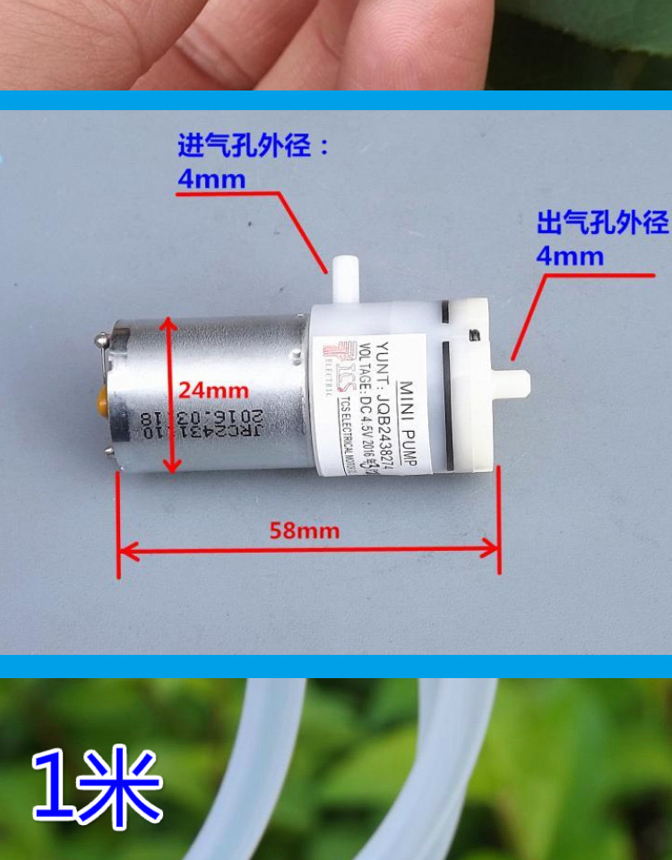

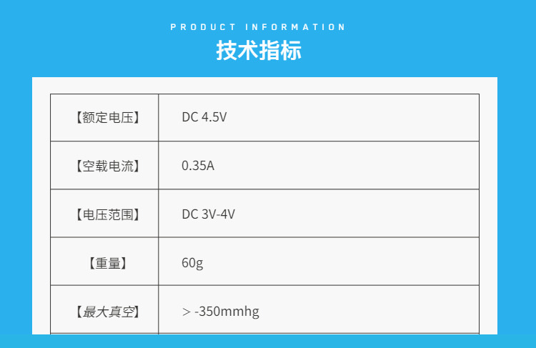

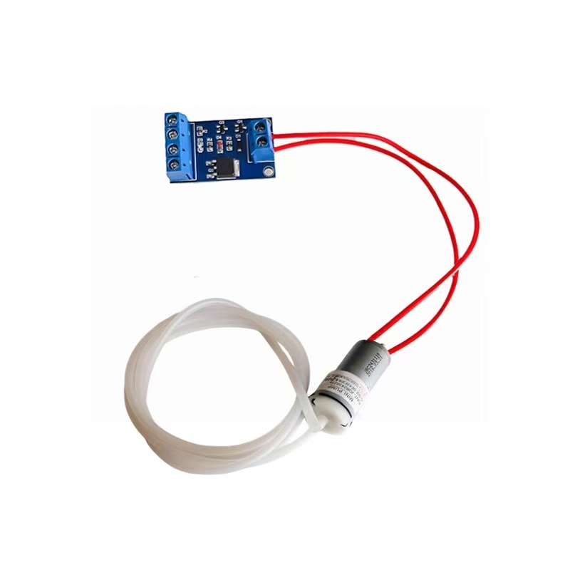

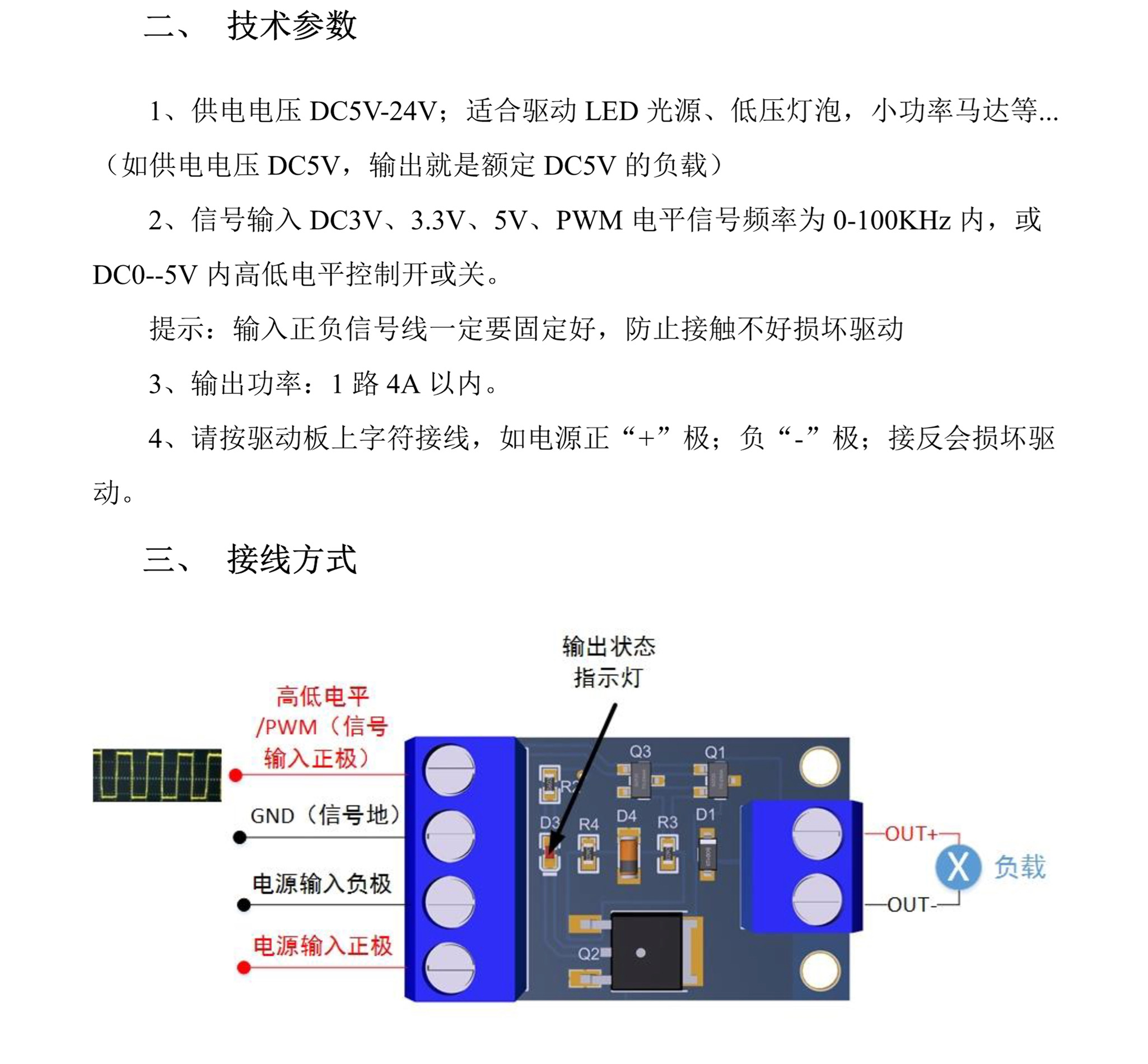

5v Air Pump

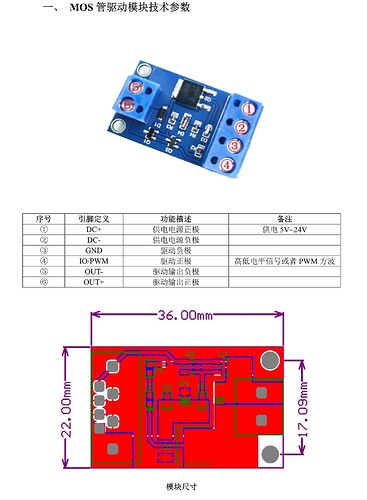

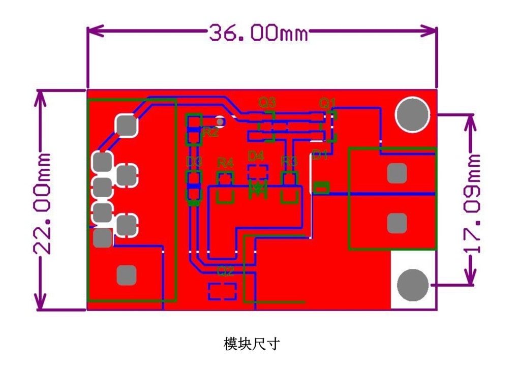

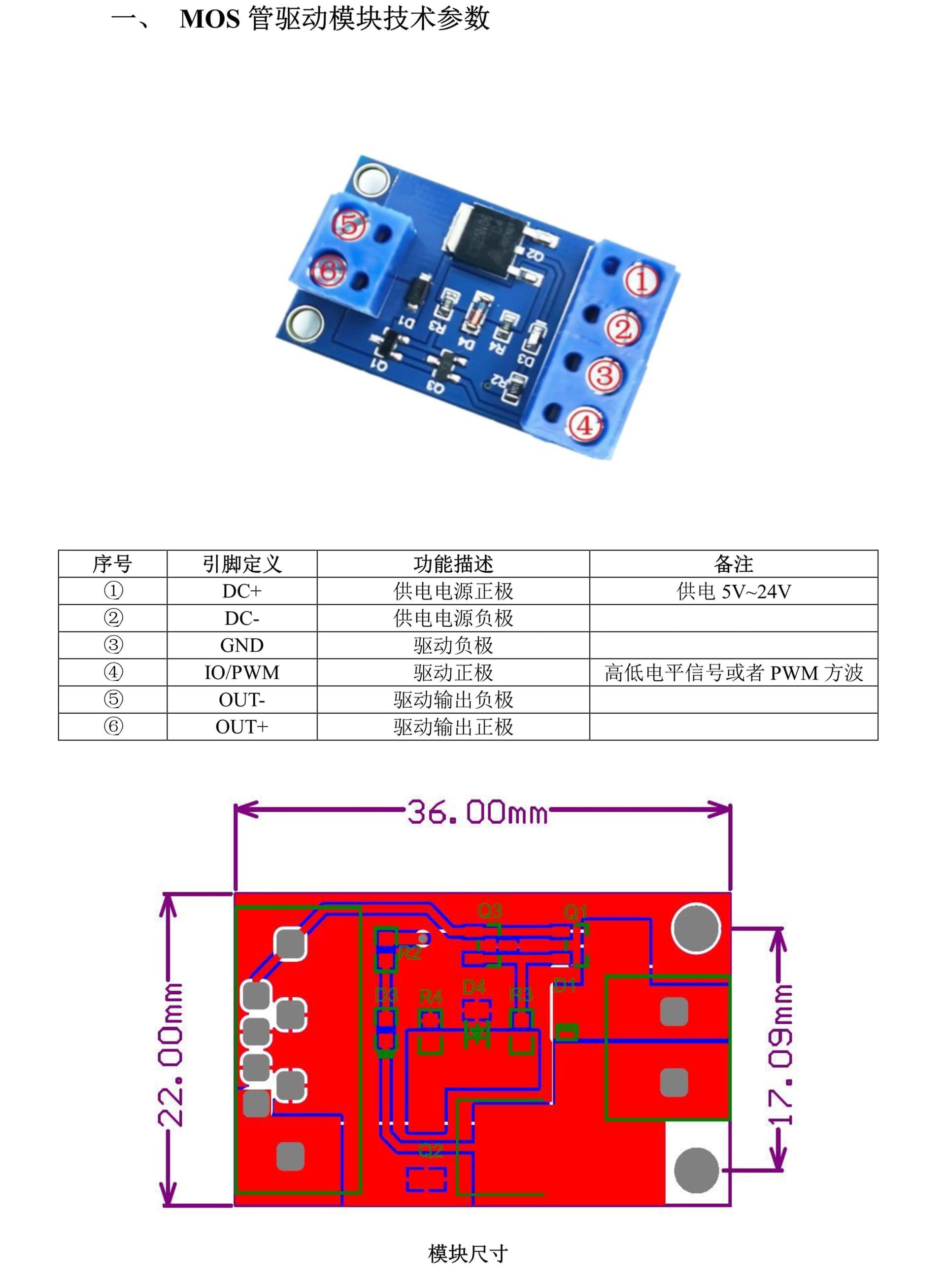

(This is the only information I could find, and I’m not sure if it’s enough)
Thanks a lot for your help!
