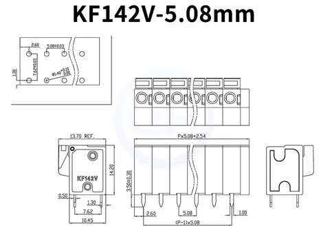

KF142V - 5.08mm

Top view❗
Datasheet❗
https://es.aliexpress.com/item/1005009248924968.html?spm=a2g0o.order_list.order_list_main.5.4a33194duPXppO&gatewayAdapt=glo2esp#nav-description

Right, sorry about that. There are two versions — horizontal and vertical connection. I want the vertical one, the 4-pin model.
This part should do what you want. Before ordering boards print the pcb footprint out at 1:1 scale (the default) and compare it to a real part.
kf142V_5_08mm-4p.fzpz (3.7 KB)
