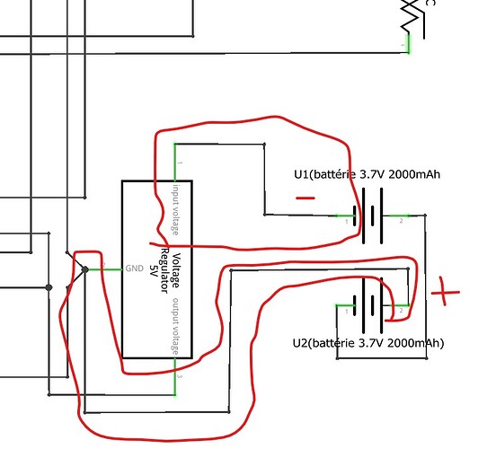

It is hard to say from just the schematic, it would be better to upload the sketch (the .fzz file, upload is 7th icon from the left in the reply menu.) That said there is a major problem (actually two) in the power. The batteries are backwards (which is dangerous with lithium batteries as they will catch fire or explode if shorted.)
the regulator needs positive voltage on Vin and negative to ground. You would also be better off with a buck switching regulator instead of a 7805 (which I assume is the current regulator) as the buck regulator is %90 efficient where a linear regulator is %20 to %30 effcient. This is one switching regulator that has a Fritzing part, there are a bunch more as well.
Without part numbers for the other parts it is impossible to say if they are powered correctly or not as what voltage they want and where depends on the particular device and there isn’t sufficient information here to tell.
