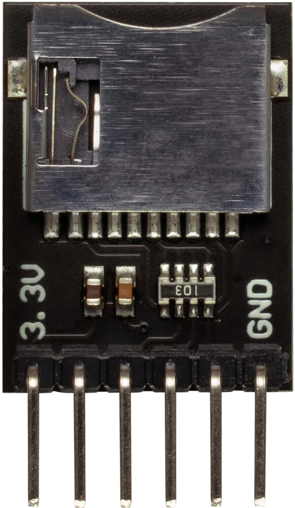

Micro-SD breakout board from Joy-it
Here is the datasheet:

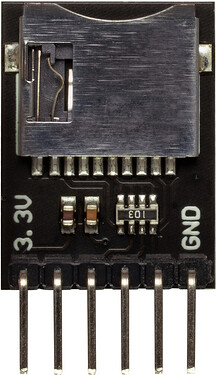

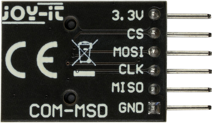

Note for those making parts:
As the data sheet he posted does not have enough information (for this part)
Here is the website:
It has all the connectors labelled
And the flat image
Assuming you want the module version (as opposed to the SMD module that I expect you would find hard to solder) there is a part that should do here
As this board appears to come with connectors soldered on, it is likely a bad choice as you would need to unsolder the connectors. A google search of the form “fritzing part Micro-SD breakout board” comes up with a variety of Fritzing parts and choosing one of them would be a better bet.

OK, I have cloned this part from a forum post (somewhere…) submitting a Micro-SD Card Module. After changing the connector names and fixing the part, I’m done.
Note: Please ignore the gold square in the PCB view (I’m too lazy to change it as it won’t affect anything!)
@AnnePloir Here is the part you want
Joy-it Micro-SD Breakout Board.fzpz (11.6 KB)
@vanepp any problems/issues with the part?
