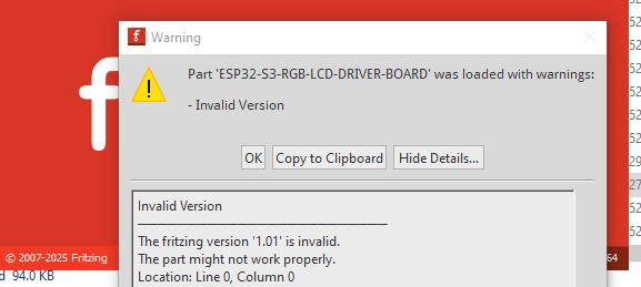

Your part has a number of problems. First the version number is incorrect which on Fritzing 1.0.5 causes this:

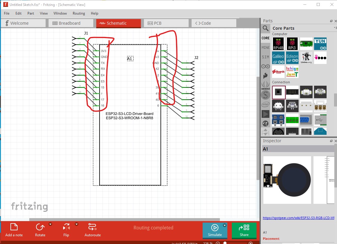

It probably (despite the message) won’t affect anything but is annoying as you need to hit OK to load the part every time. Breadboard looks OK, but schematic has several problems:

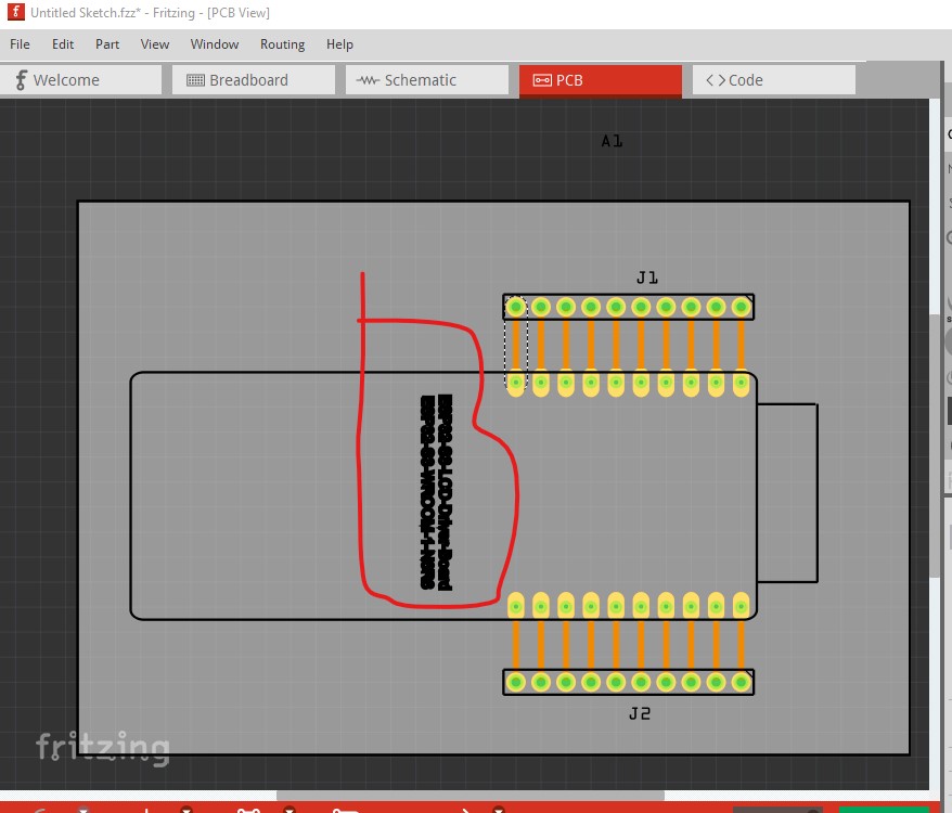

Most of the pins lack terminalIds which causes the part to be misaligned to the grid and the connector to connect in the middle of the pin (which is also where the grid is aligned) rather than the edge as it should. In pcb it is preferable to not add text as you need to change the part to remove it and the user can add it if they want it in the sketch. Something is also off about the font or font-size as it isn’t displaying properly.
Although it won’t affect anything operational, pin numbers are supposed to start at 0 not 1.
FritzingCheckPart.py flags the following errors (all to do with the terminalId being missing with the result we see in schematic.) and the not starting at pin 0:as well as bus errors.

You appear to have buses defined but not correctly as the ground pins are not bussed together as they should be. All of these issues can be corrected with information in this tutorial.
