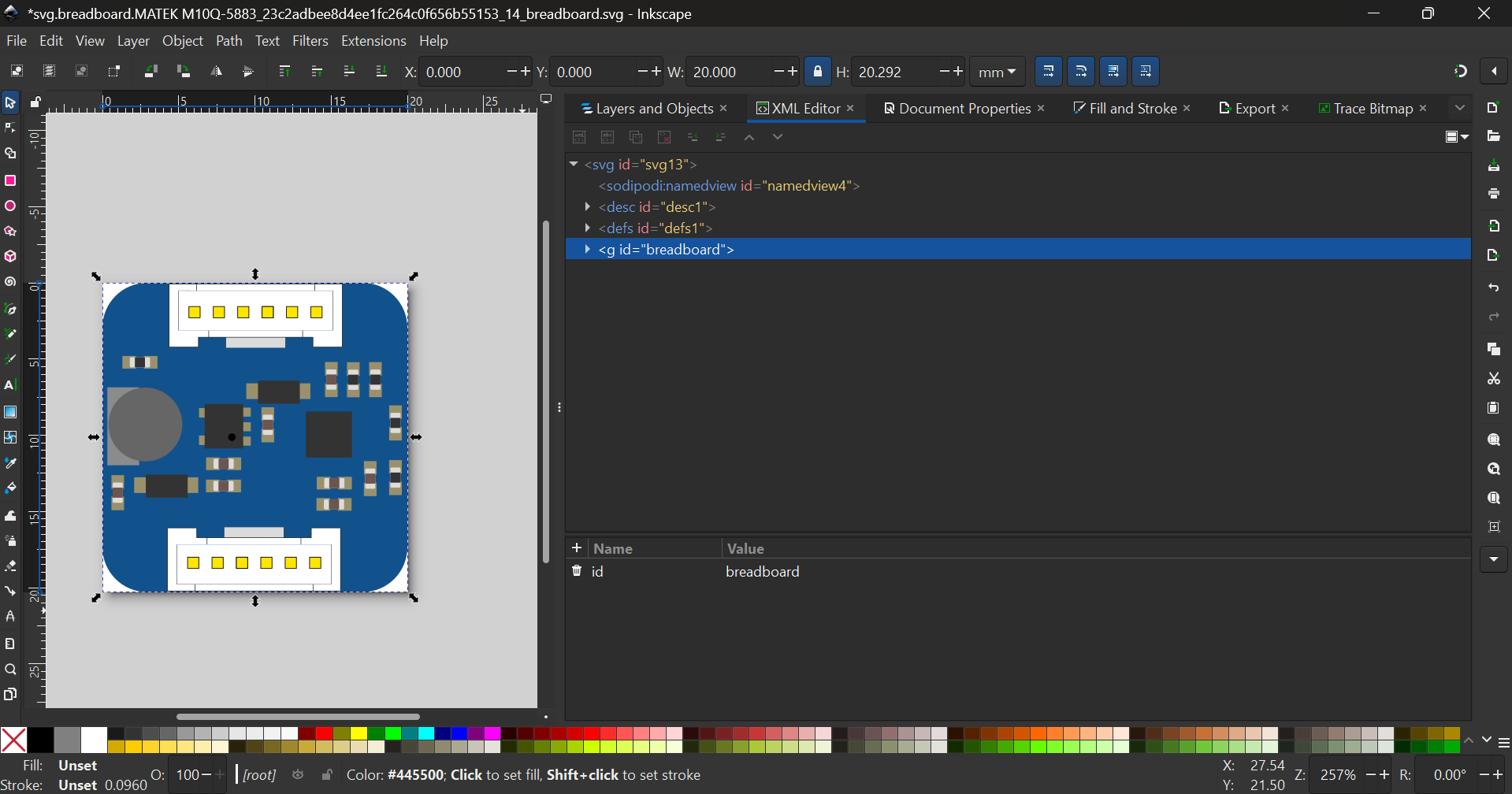

I made a custom Fritzing part for the Matek M10Q-5883 module, which includes:
  • Breadboard view with realistic image
  • 12 functional connectors (6 left / 6 right): 5V, RX, TX, SCL, SDA, GND
  • Ready to be used with any ESP32 / microcontroller GPS project
Thanks to ChatGPT for the SVG and connector help :wink:
Feel free to reuse, modify, or improve it!
:arrow_down_small: MATEK M10Q-5883.fzpz (96.3 KB)
MATEK_M10Q-5883.fzpz
Enjoy!
@Billy64 Please DO NOT take the easy way out and SEND BITMAP IMAGES IN SVG
Too realistic to be used.

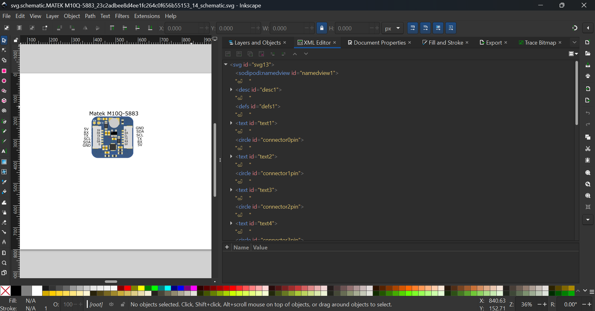

And what sort of schematic is this ???
This is the second and last time I’d like to repeat that in this forunm
@Billy64 PLease look at
@Billy64 AI can NEVER NEVER CREATE FRITZING PARTS!!! Please DO NOT use AI for parts as well

Hi @RAPTOR7762 AI didn’t created it, I’have done it myself, but it’s true with the help of ChatGpt.
You’re right ChatGpt cannot do it itself
This is my first Fritzing part, I had no idea how to do before
Hope it helps
I’m really sorry if I done it wrong.
I just wanted to share with my first one to help, I was proud to show, but if you think it’s better for me not to share, I won’t share anymore.
@RAPTOR7762 While I wouldn’t advise to use bitmaps within vector graphics, if it works for the purpose, why not.
For sure it won’t pass the automated tests, and even look broken in some situations.
But it might be a first step, the next iteration of the part can be improved (by anyone, since it was shared here) Thanks @Billy64 . Creating Fritzing parts is still quite hard, we are working on that.
Yeah I plan to do so tomorrow
Understandable. I’ll help you in your future parts
Thanks @KjellM I want to precise that the only thing is 100% AI is the text of the message it suggests when I tell it I finished the work.I made a copy/ paste of the message, Only the message.
The image (sorry if it is not a good format) was selected and redrawed by my self and all the pins also
Hi @Billy64
I’m now redoing your part. Breadboard graphics should always look like this
I will complete the part by tomorrow
@Billy64 Here’s your fixed part
MATEK M10Q-5883-fixed.fzpz (6.8 KB)
