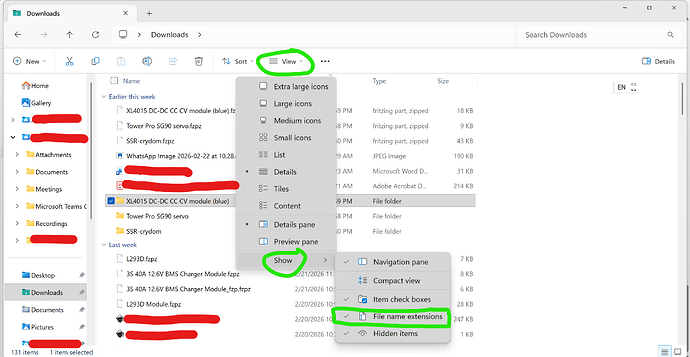

In some devices, using 7-zip to create an archive can produce a corrupted zip file. In this case, make sure you show file extensions

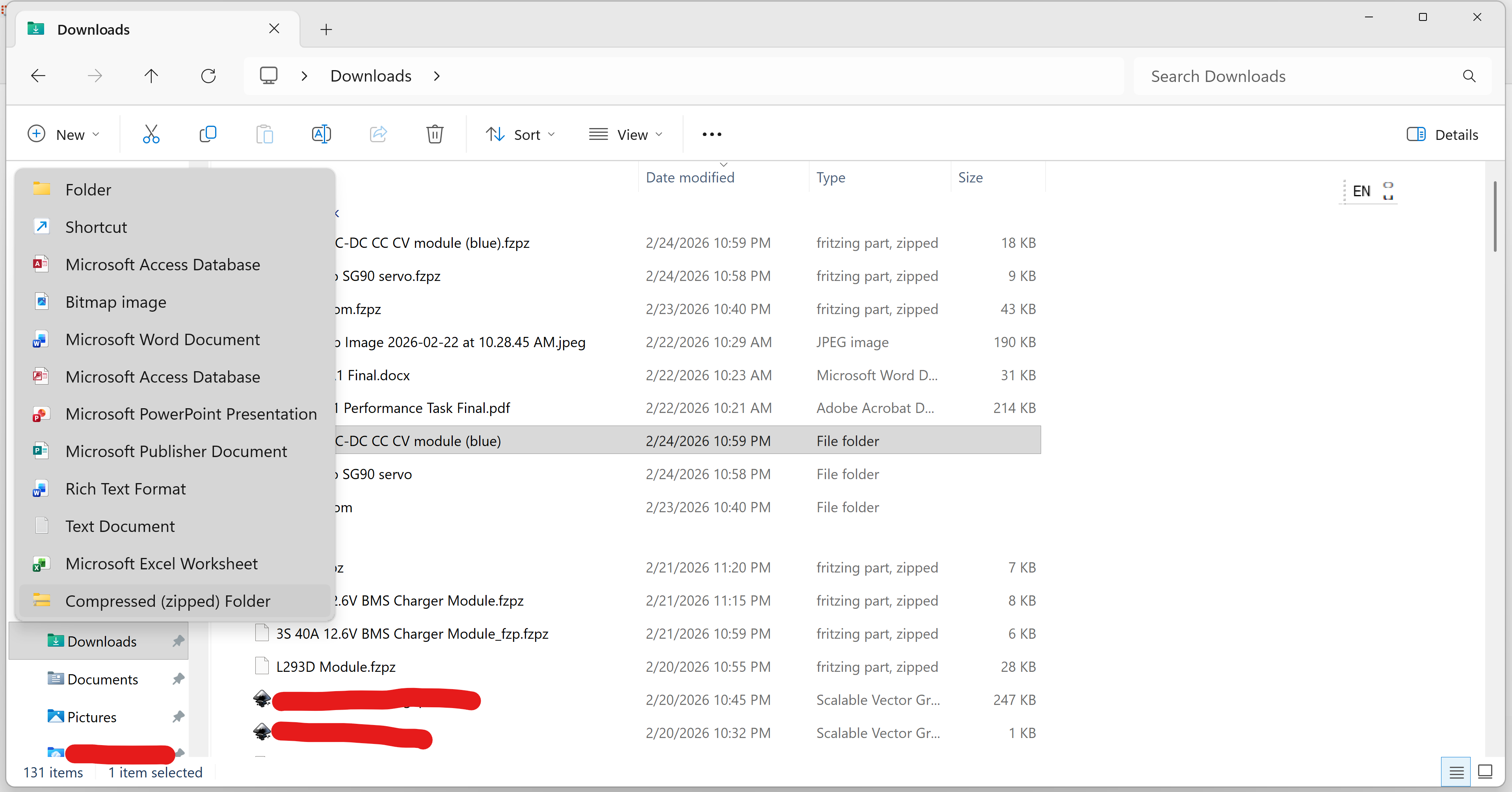

Then, click on New → Compressed (Zipped) Folder

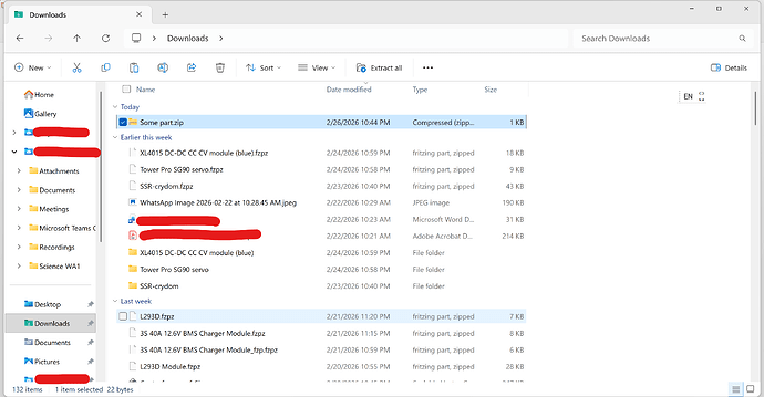

Rename it to a file name

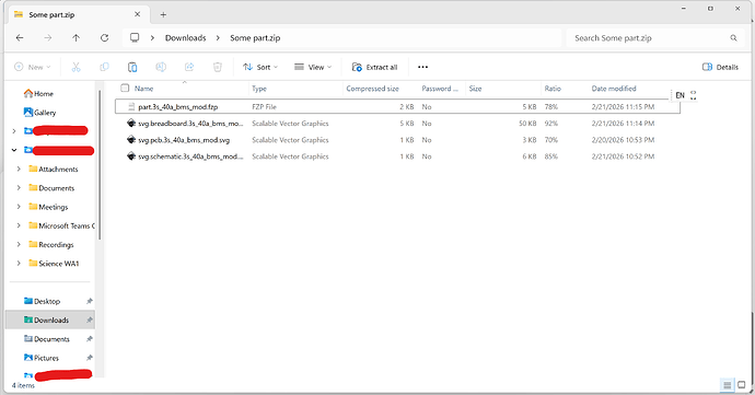

Open the newly created ZIP file and put all your things inside

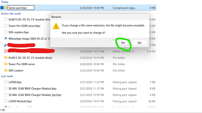

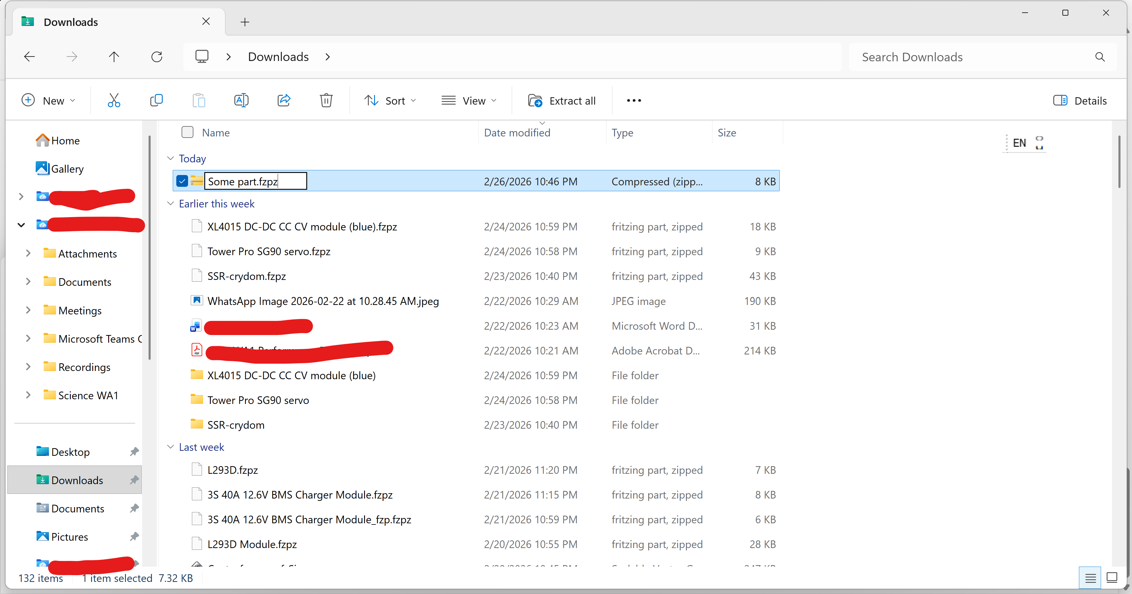

Go back, and rename the .zip to .fzpz
Press enter → Press Yes
Done :slight_smile:
