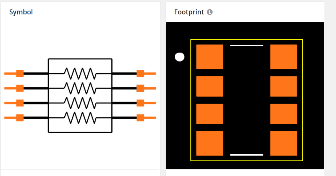

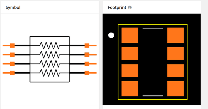

There appears to be something on Snapeda:
there was an .lbr file available when I selected EAGLE, I do not seem to be able to attach the file as such, so I will quote the content at the end of this message.
