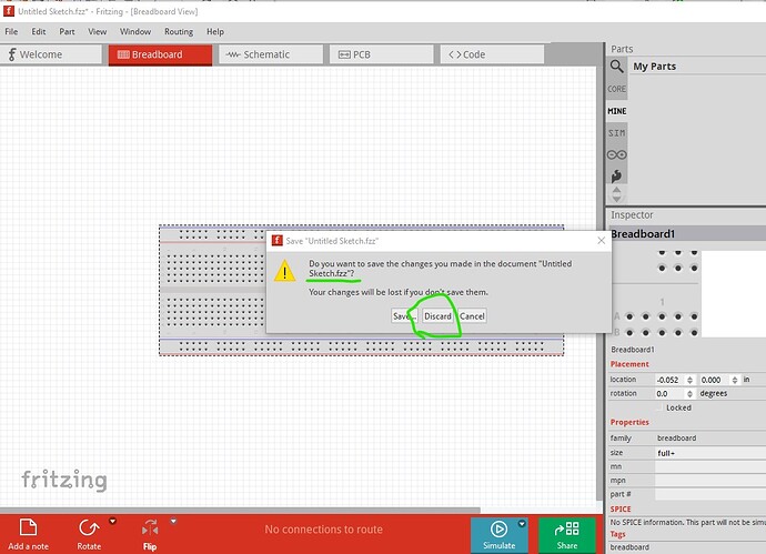

You should then be able to delete the part and then exit Fritzing (which is required to actually remove the part!)
At the first prompt answer yes to modify the parts bin. Then answer discard (because you don’t want to save the .fzz file)
then answer save to the next prompt (I suspect you answered discard either here or at the first prompt and then the opposite here)
this then deletes the part and will let you reload it. If you answer save to the first prompt but discard here it will save the part but delete it from the mine parts bin which I think is likely what happened. Now I will have a look at the display you want and see what I can do.
