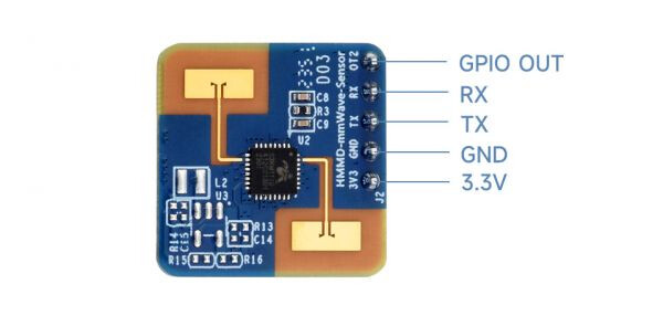

Name of the part❗Waveshare HMMD mmWave Sensor
Top view❗
Datasheet❗https://www.waveshare.com/wiki/HMMD_mmWave_Sensor#Hardware_Connection
Top view❗

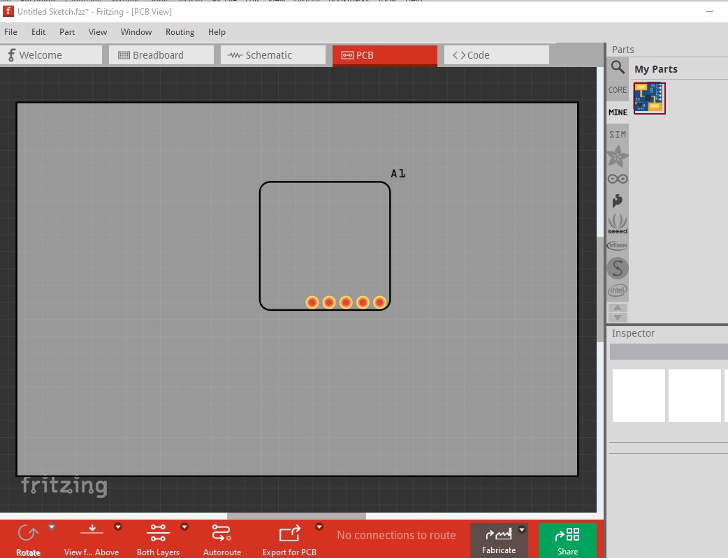

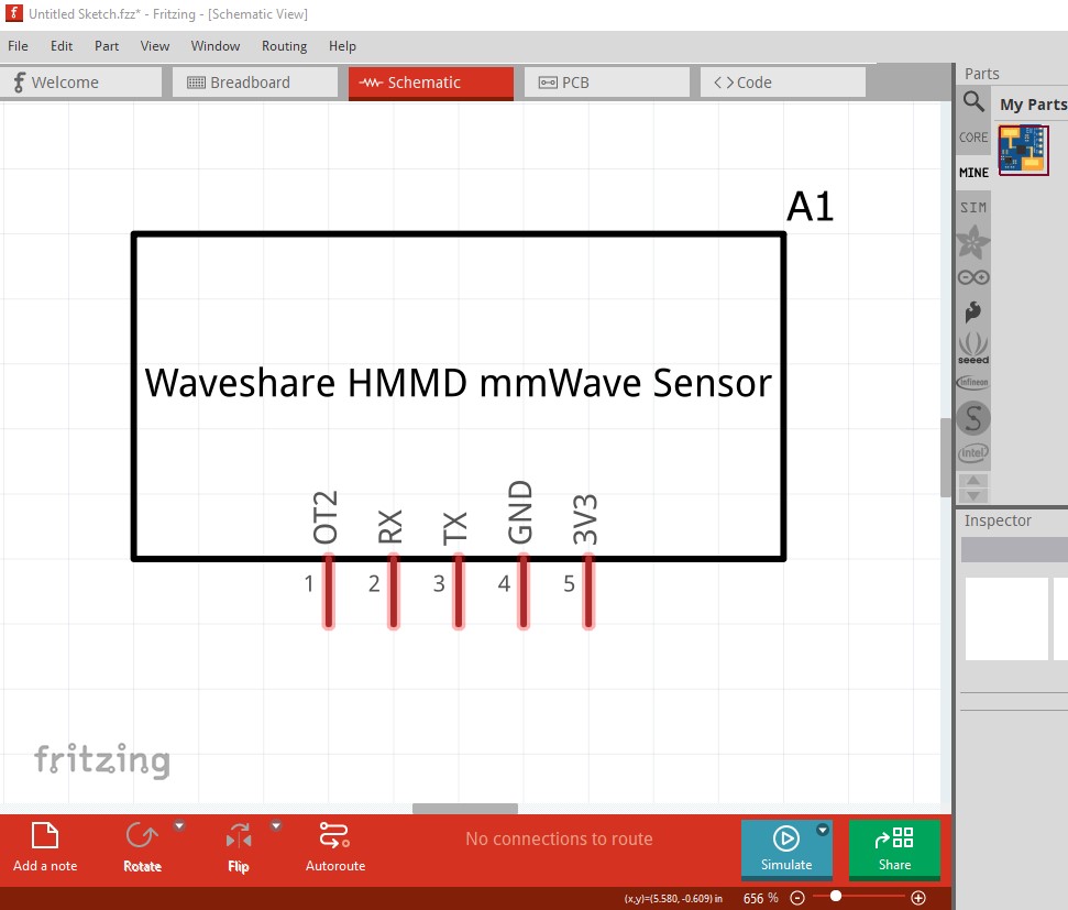

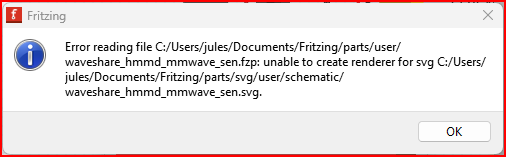

Great, thank you. One slight problem, which does not affect my use of the part, when opened Fritzing reported an error “unable to create renderer for the file”:
Will this be a problem for other users?
Huh, loaded perfectly fine in my machine. I’ll check again

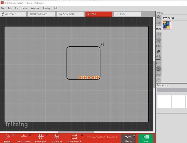

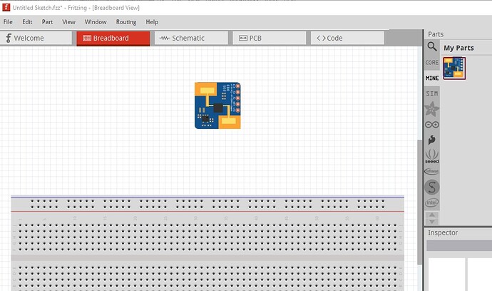

The supplied .fzpz file works fine for me on Fritzing 1.0.6 as well:
It looks like you have a problem of some kind on your machine.Your machine looks to be having a problem reading or rendering the schematic svg file for some reason.
That explains it - I am running an old version (0.9.3), so I will update it to 1.0.6.

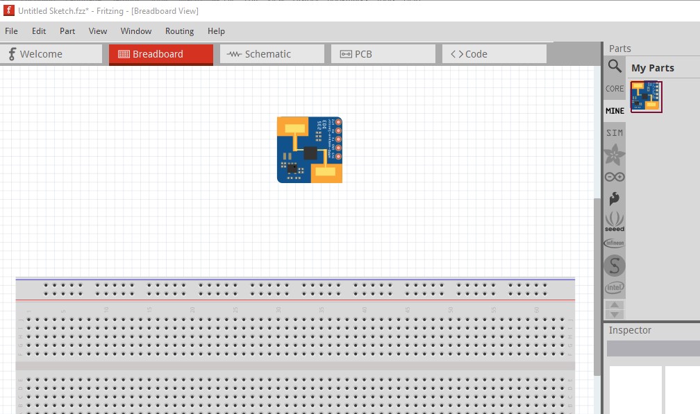

Okay, works fine now, version 1.0.6 on Windows 11 (my old version was from my Windows 10 machine).
Yes on 0.9.3b I get the same error, the schematic svg won’t render. Don’t know why because schematic looks normal.
