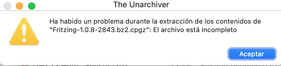

Version 1.0.8 for Mac attached file is wrong
The attachment in the Mac OS version does not have an attachment. DMG
In the bz2 Archive is a zip-File, which contains the bz2 file.
When I extract the archive on another host with bunzip and look at the file:
Fritzing-1.0.8-2843: DOS/MBR boot sector; partition 1 : ID=0xee, start-CHS (0x3ff,254,63), end-CHS (0x3ff,254,63), startsector 1, 1638479 sectors, extended partition table (last)
That’s not a dmg-File.
Can you please check the Release?

1.0.8 is a bz2 archive, which does not contain a dmg-file.
Exactly, that’s the problem, it doesn’t have a .dmg file
I thought I saw another post here about some browser or configuration downloading a dmg file as a zip. Try just renaming the downloaded file to .dmg instead of .zip
rename .bz2 to .dmg, it works
That did the trick.
Renaming the bz2 to dmg.
Thank you KirkChu!
Ok, perfect. Thanks a lot
