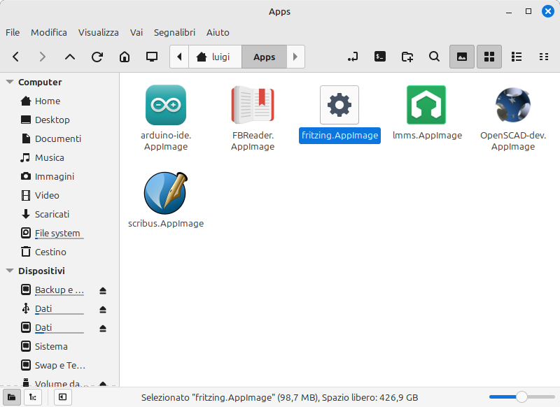

Version 1.0.5 without icon from LinuxMint 22.1
Hi, my name “Luigi” born italy . my engish elementary no speak english.
My problem:
My download fritzing. and rename short name.
Icon not found?
Thanks.

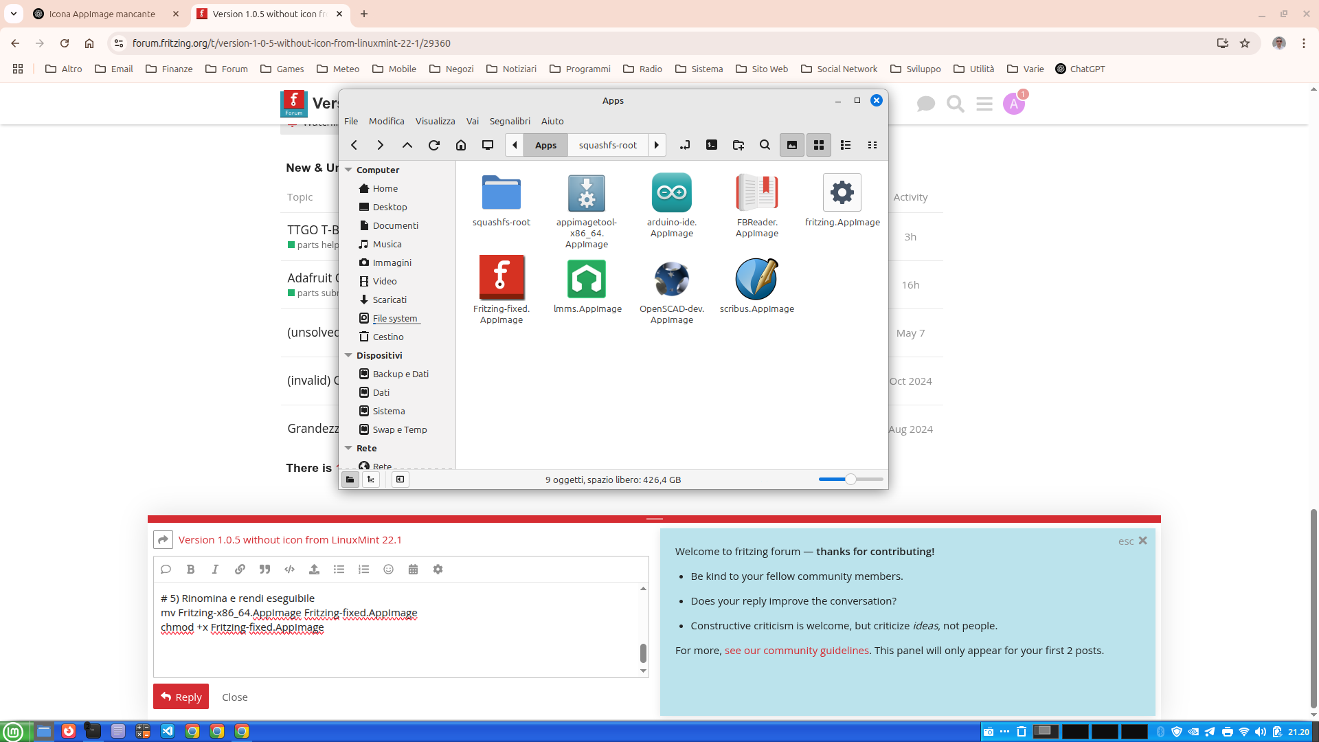

ok, my fix:
1) Rendi eseguibile
chmod +x Fritzing.AppImage
2) Estrai
./Fritzing.AppImage --appimage-extract
3) Sostituisci l’icona
cp ~/nuova_icona.png squashfs-root/.DirIcon
4) Ricrea
wget https://github.com/AppImage/AppImageKit/releases/latest/download/appimagetool-x86_64.AppImage
chmod +x appimagetool-x86_64.AppImage
./appimagetool-x86_64.AppImage squashfs-root
5) Rinomina e rendi eseguibile
mv Fritzing-x86_64.AppImage Fritzing-fixed.AppImage
chmod +x Fritzing-fixed.AppImage
