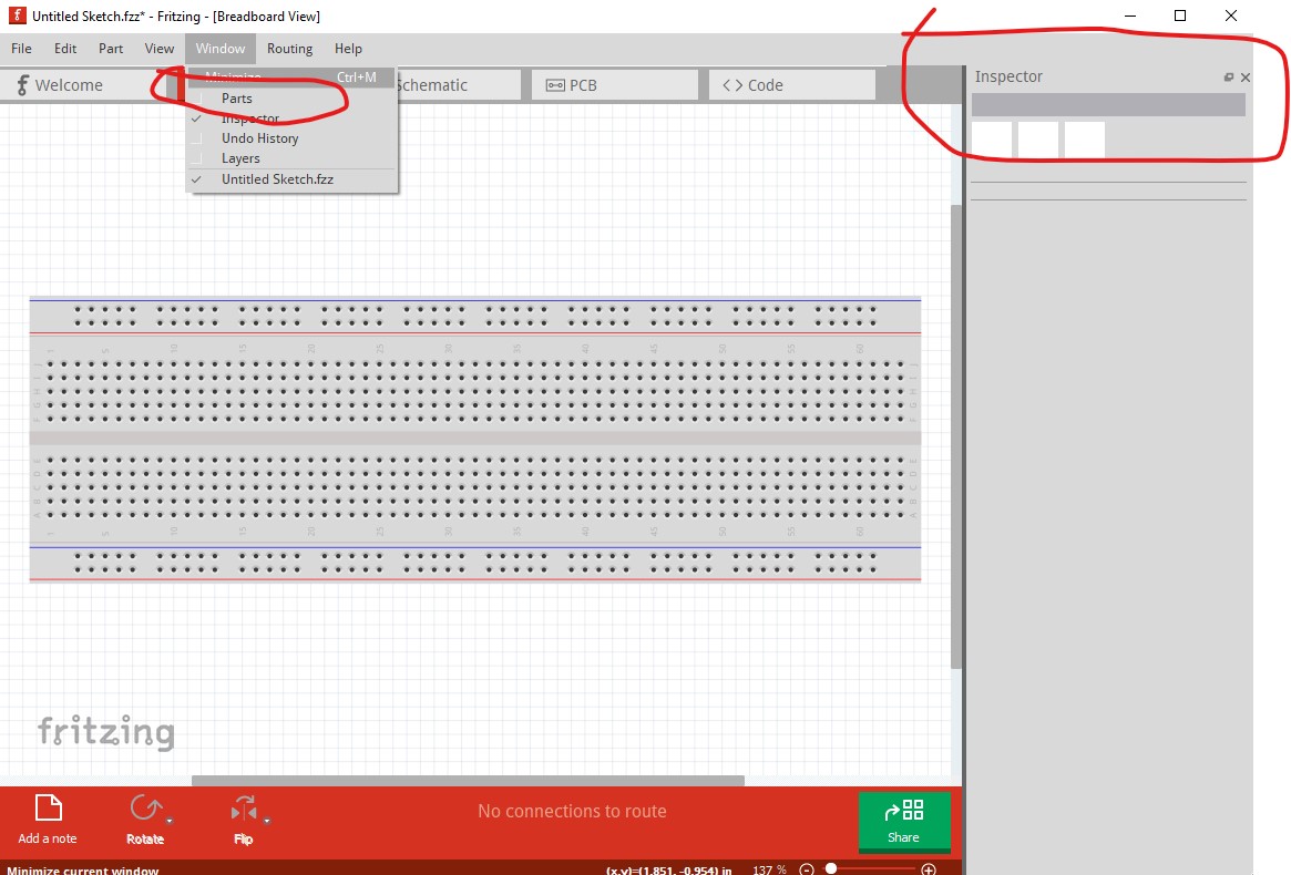

I am not able to see the window where the parts are (on the right side) I see on the window menu that the Part is checked but it is not there on the display.

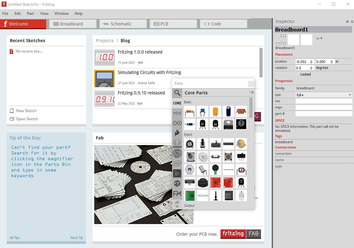

There appears to be something wrong in your system. I read your message as saying the parts section is checked in the Windows menu like this:
(which correctly displays the parts on 0.9.10 under Win10 for me) but the parts aren’t showing up like this:
(here the parts section is not checked and parts don’t appear) both of these displays are from 0.9.10 on Win10. The only other thing I can suggest is clearing the user directories in case 1.0.0 did something to something in the user directories. The instructions (and warnings!) are here

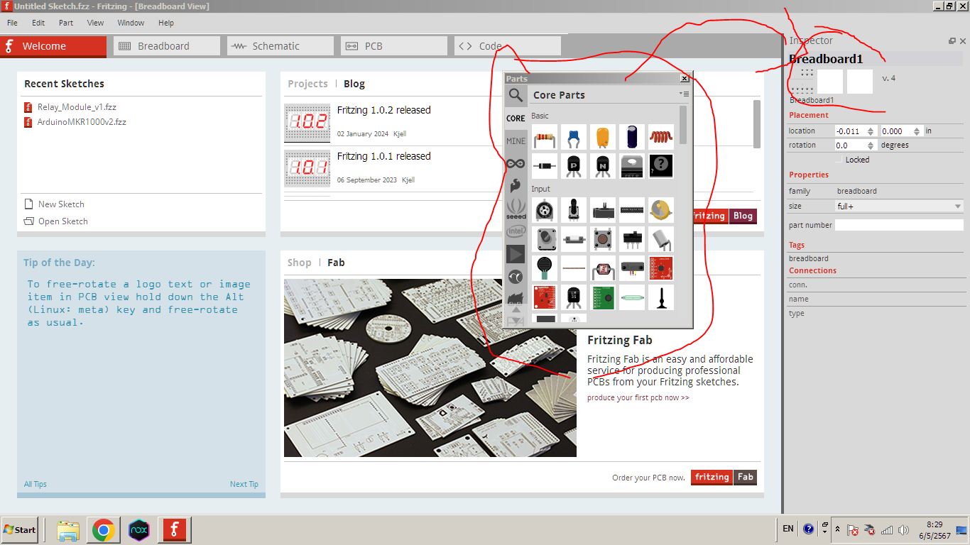

Memory says that is a dockable window, so if it it is checked as being shown but cannot by seen, perhaps it is under another window, or dragged to the edge of (almost off of) the screen.
Good thought! It is indeed undockable
and can be moved off screen. I don’t off hand know how to make it dockable again though (but I expect clearing the user directories would clear it back to being docked!) Looks like dragging it back to its original location redocks it.

wait. Drag it like I did :
