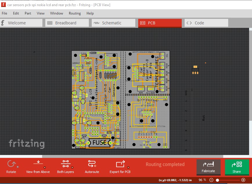

Upload the sketch (the .fzz file, upload is 7th icon from the left in the reply menu) and I will take a look. You may also want to update your parts repository because the missing .fzp file should be there:
car sensors pcb spi nokia lcd and rear pcb.fzz (69.6 KB)
Works for me on 0.9.3 (and 0.9.9) on Windows:
The best I could suggest is clone your parts repository from the repo on github on the assumption the .fzp file is missing from the repository. You should find the file
ls fritzing-parts/core/sparkfun-connectors-rj45-8-pth-fix2.fzp
in the fritzing-parts directory in the Fritzing installation directory. If (as I expect) it is not there or not permitted correctly you will get this error message. Try and do a parts update from Help->Check for updates in Fritzing and see if it wants to load a new parts update (it should if as I suspect the local repository is corrupted!) Otherwise you can do a git clone of the parts repository on github in to the parts directory above then start Fritzing and run Part->Regenerate parts database which will run then exit Fritzing. When you restart Fritzing things should work.
Thank you. Glad to see that my files are not corrupted .
