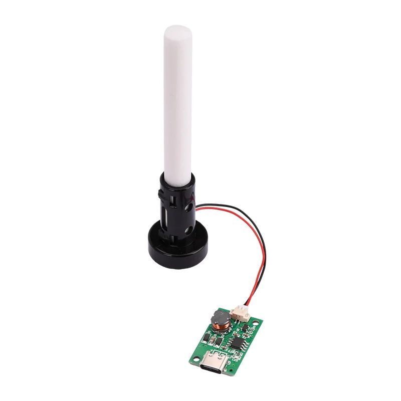

Can you help me with a part for an ultrasonic nebulizer 1PCC 5/10PCS DC5V USB Ultraschall Vernebler Luftbefeuchter Vernebler Fahrer Modul Mini Luftbefeuchter Diy Kit Typ-C mit Zerstäuber Blatt - AliExpress 502

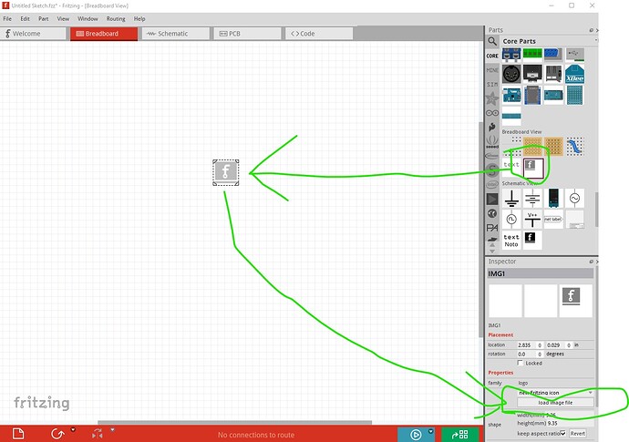

There isn’t much to make a part from this. It has no connections that will appear in Fritzing. You can make as much of a part as is possible by importing an image in to breadboard like this:

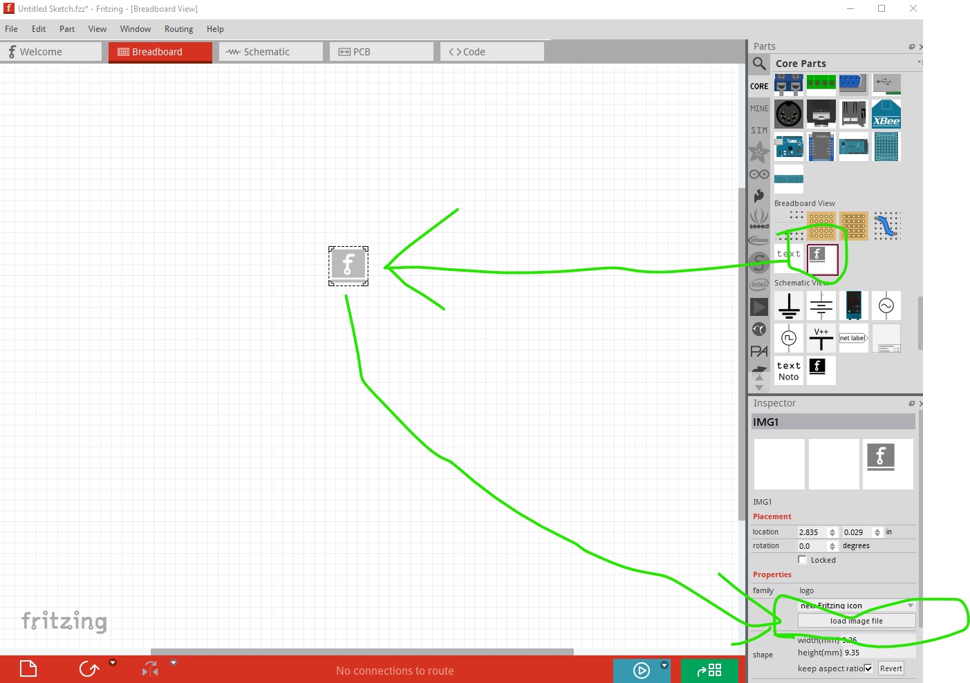

Then load this jpeg file

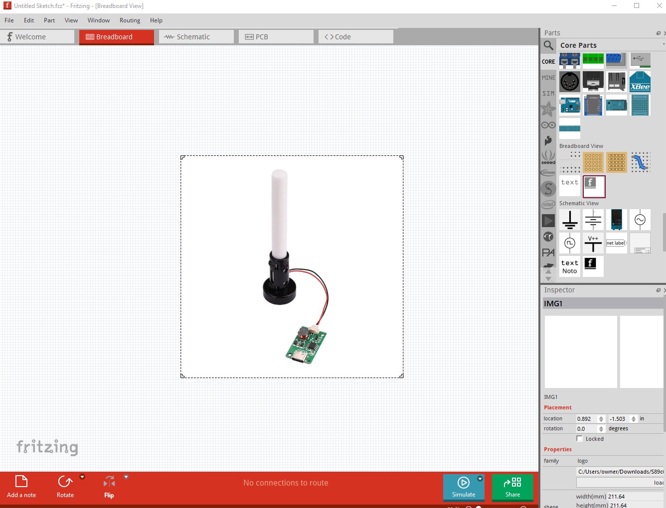

to create this display in breadboard
As noted it won’t connect to anything because the USB connectors in Fritzing have no connections but it will give a visual represent ion of the device.
