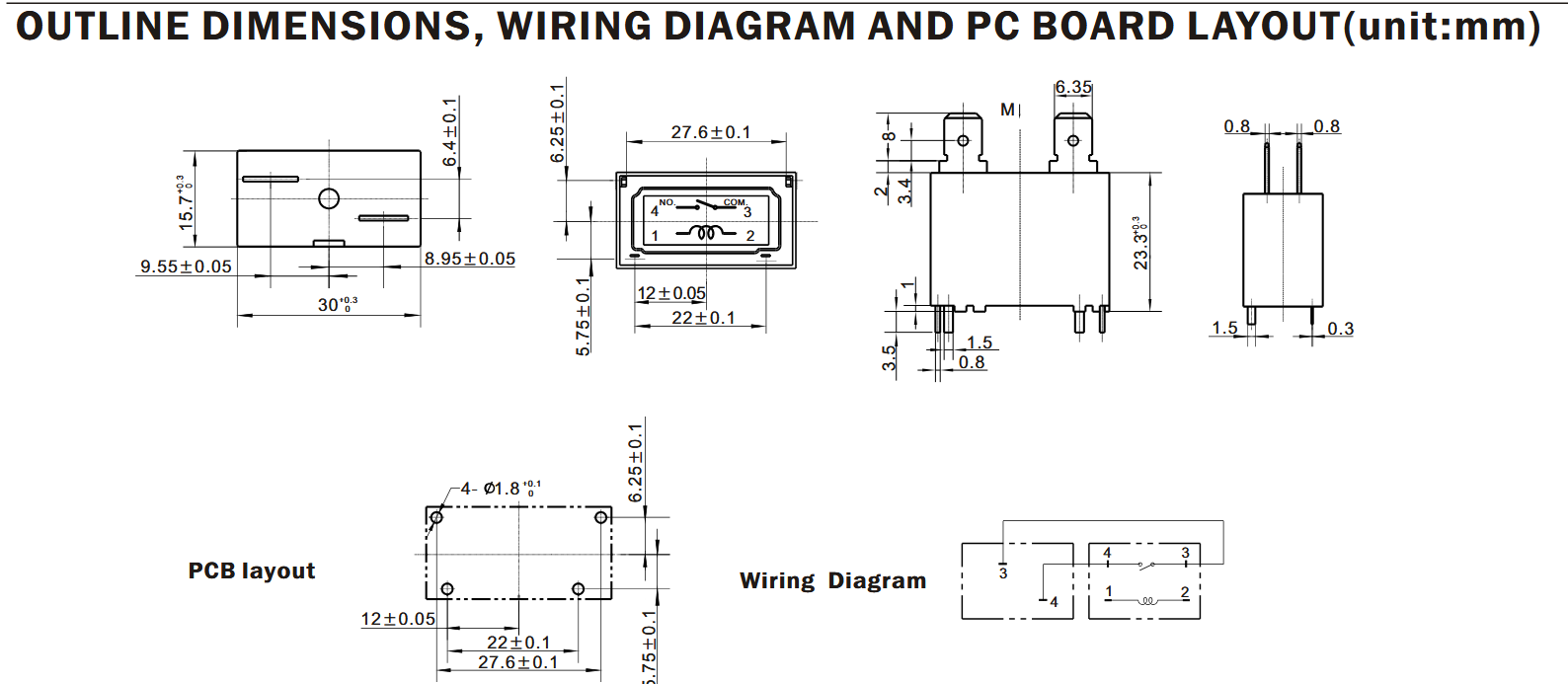

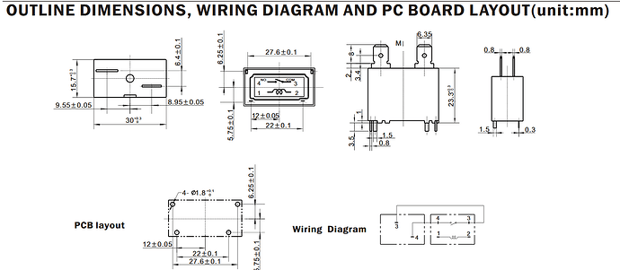

Ultra-miniature pc board type power rel ay
ULTRA-MINIATURE PC BOARD TYPE POWER REL AY
UL,C-UL File No.:E179745
TUV File No.:40007481
CQC File No.:CQC02001002131
[ x] Relay (K)
This part may do what you want. The datasheet does not specify top view or bottom view so I assumed top view, if it is bottom view the connections will be incorrect. The mounting hole is only on silkscreen. If you want a mounting hole you need to drag in the core parts→pcb→hole part position it over the hole in silkscreen and then set the size appropriately to drill the hole.
relay-skf112dm.fzpz (4.2 KB)
Peter, that’s perfect! I printed it out and checked, and it matches exactly. Thanks a lot!
