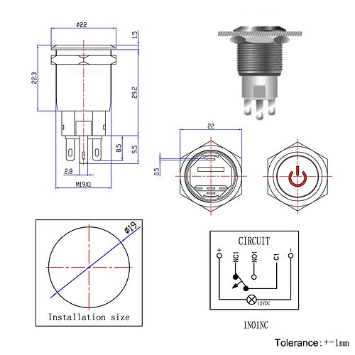

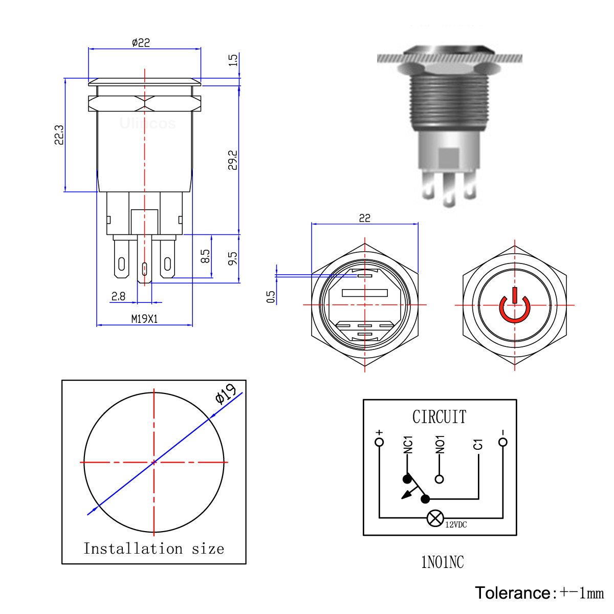

U19C1 Toggle Switch
This is to add support for U19C1 toggle switch. Not perfect but works, my first one.
File:
U19C1_Toggle_Switch.fzpz (3.8 KB)
Specs:
Operation Mode: ON-OFF
Current Rating: 5 A
Operating Voltage: 250 volts
Contact Type : Normally Open
Connector Type : Plug In
Brand: Ulincos
Switch Type: Push Button
Terminal: Spdt
ref:
