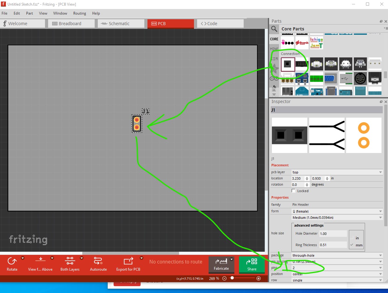

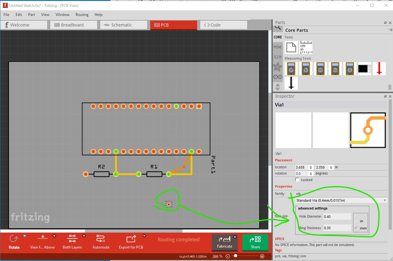

You would either need to find a buzzer part with a 3mm pitch (a google search of the form “fritzing part buzzer 3mm pitch”, doesn’t look like there is one though. So you would either need a custom part (which you should request in the parts help catagory filling it the template with the required information. Another alternative (which will lack breadboard and schematic though) is to use 2 single pin headers and move them to be the necessary 3mm apart. The size of the hole and the surrounding pad on the via can be changed in Inspector like this:

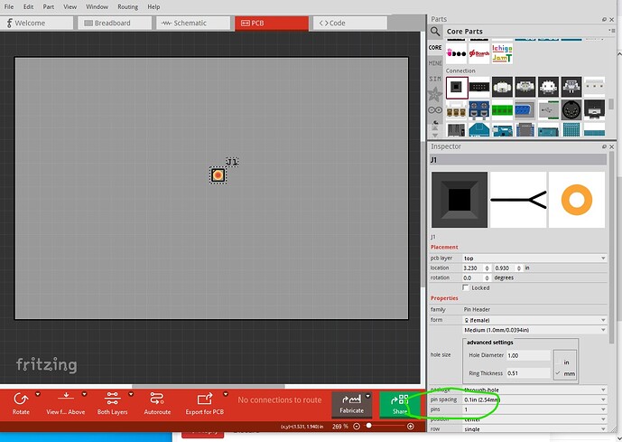

A better alternative would be to use a single pin header like this”
Then change it to 1 pin

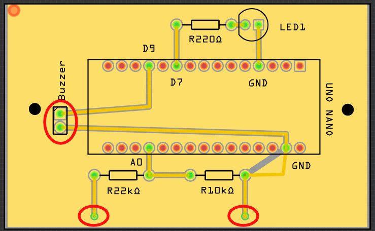

Alarme 1couche NANO 15-12-2025.fzz (25.2 KB)
Here is the file not modified. Thanks.
I finally restarted the editing process in a new file. But thanks to your advice, I managed to fix all my problems. I also found a buzzer with .3 inch (8mm)spacing. Here’s the new file.
