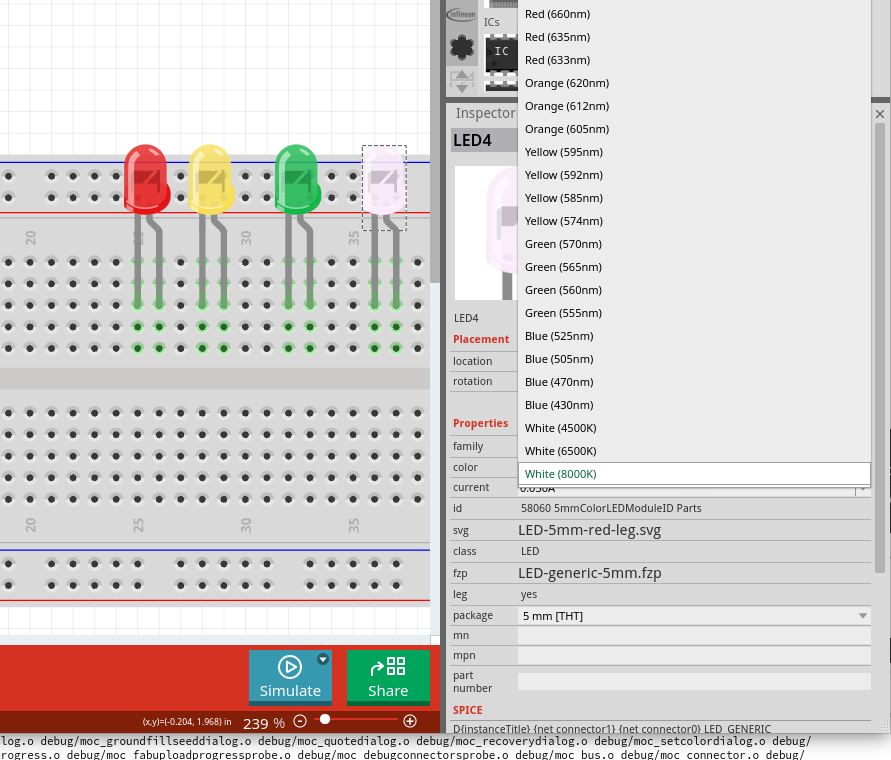

@josemari75 You can request for new parts here, and there are generic parts(eg led) that comes in different colours (select from Inspector drop down menu)
Español:
Puedes publicar en español.
Puedes solicitar piezas nuevas aquí. Hay piezas genéricas (por ejemplo, LED) disponibles en diferentes colores (selecciona en el menú desplegable del Inspector).

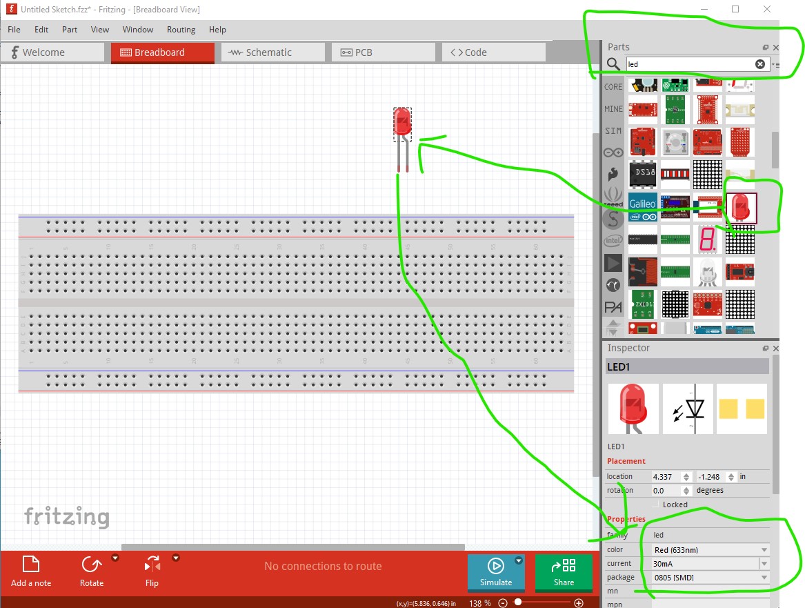

You can use the Inspector to set properties of parts,
for example the color of a light emitting diode:

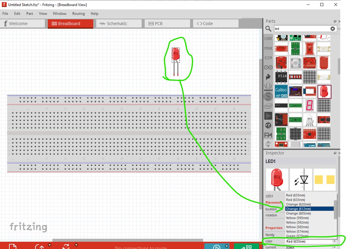

bueno, como dije soy nuevo y con 0 experiencia, donde los componentes tengo una lupa, ayi puse led y me salio leds rojos de diferente tamaño y leds azul super flux (que no es el tipico led) no tengo ninguno mas…
¿como podria tener leds verdes y azules para sumarlos a mis componentes?
gracias

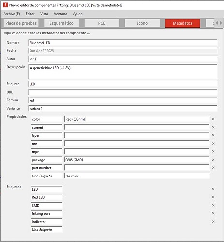

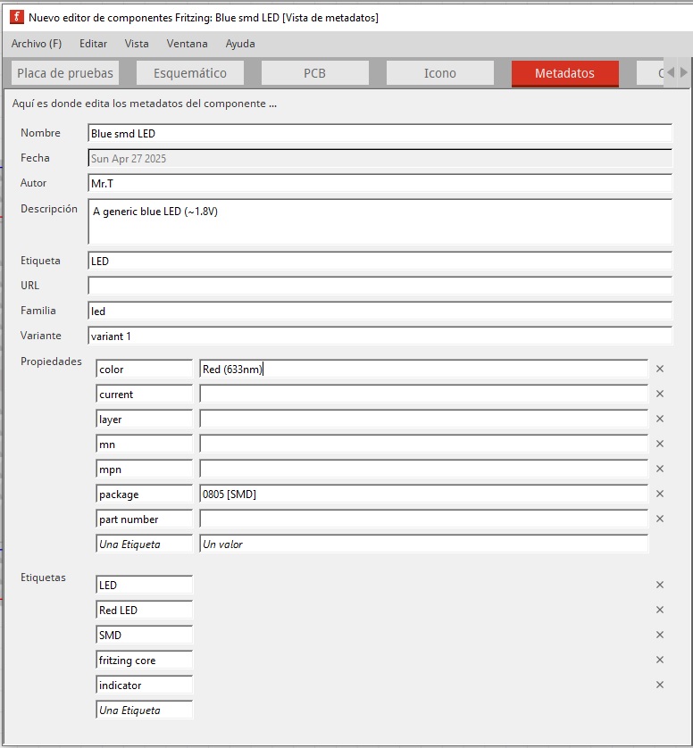

bueno, cogí
uno de esos leds y como se ve, no hay un desplegable para seleccionar el color como en el tuyo
You need to copy the led in to the sketch (they can’t be changed in the part bin only in a sketch) like this.

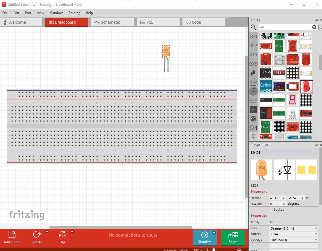

once in the sketch the color can be changed in Inspector (the lower right window) but only for some components, those that will change will have drop down boxes for the parameters that are changeable.
selecting orange will change the color to orange

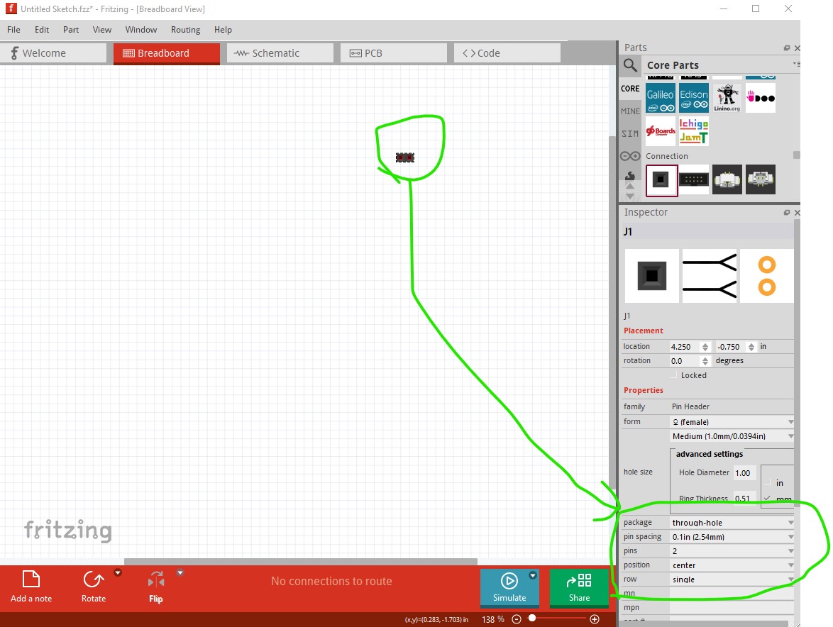

dragging in a header connector

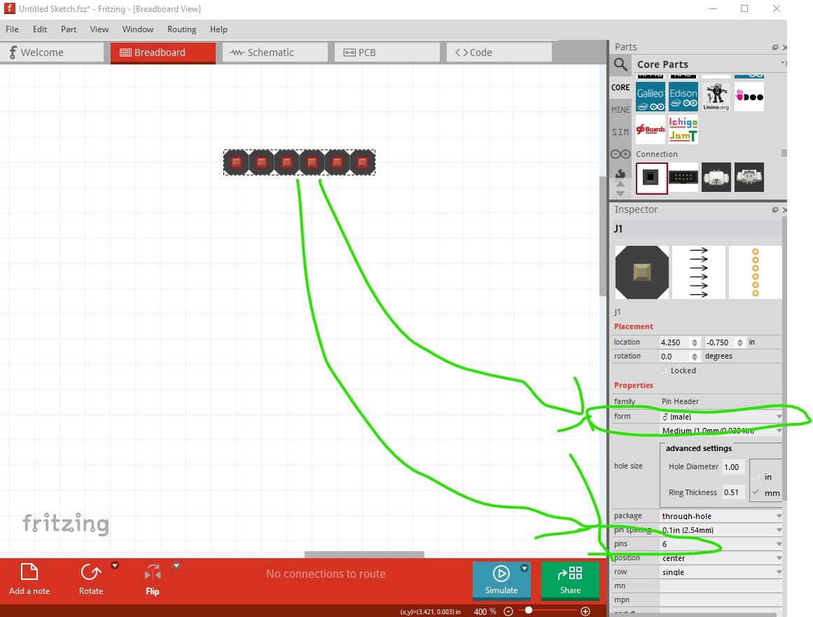

will allow you to change the sex (male female or a variety of other options) and the number of connectors
here to a male 6 pin header. There are a variety of other part that are the same (screw terminals for one probably some others I don’t currently remember.)
That is because your LED is in the part bin not in a sketch. it will only change in the sketch.
