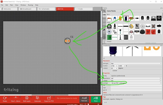

I’m inserting the “electrolytic capacitor” component, but I can’t set the pin spacing to 5mm.
Is there a way?
Thanks
Yes. Drag the capacitor in to the sketch (required to make changes)

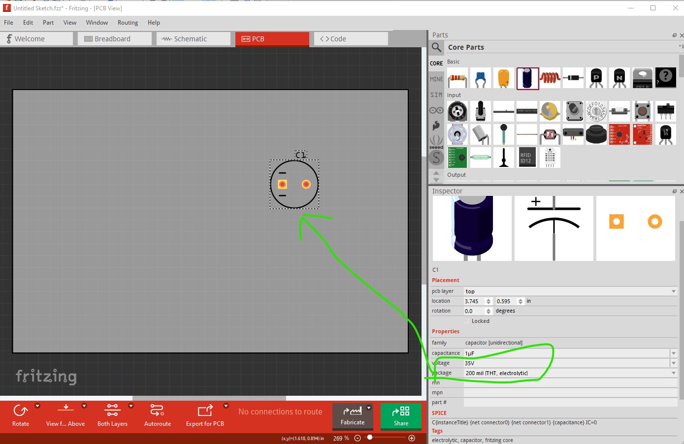

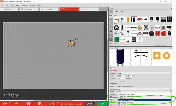

then use inspector to set the pitch to 0.2in (5.08mm)
which procduces
