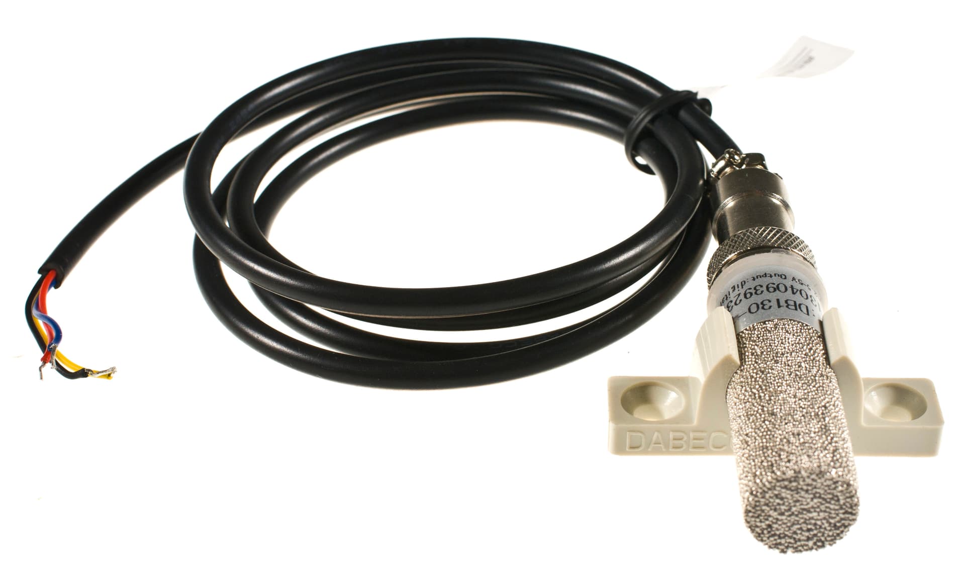

  • Red wire - 5v
  • Blue wire - GND
  • Yellow wire - Clock wire
  • Black wire - Data wire
