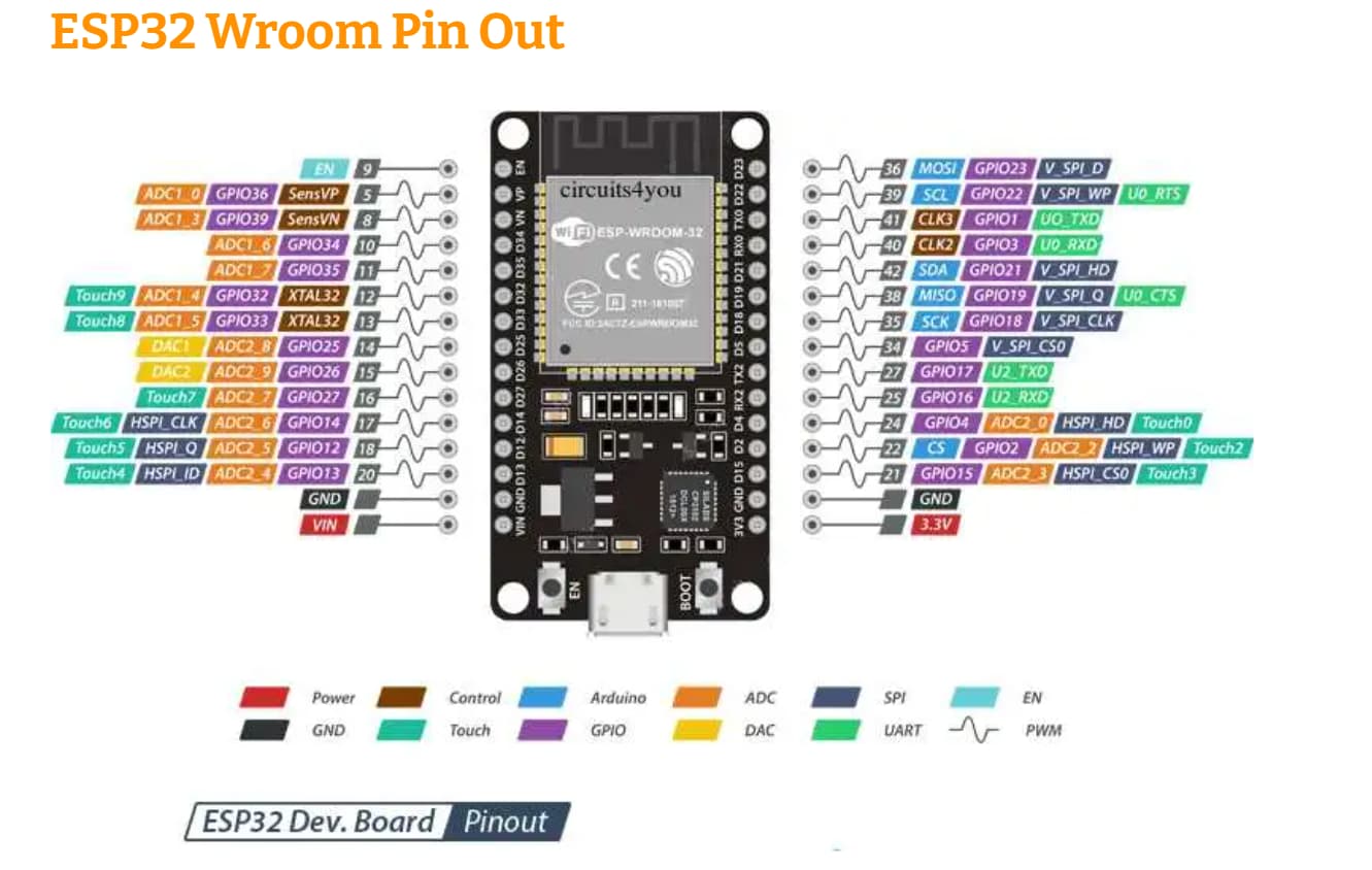

Searching for this exact esp32
Many thanks.
A google search of the form “fritzing part esp-wroom-32” (which is the best way to find parts) turns up a variety of hits one of may do what you want.
