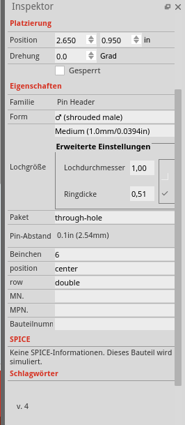

would the connector help you. I took a PIN connector from Fritzing and adjusted the settings. You can see my settings in the screenshot. I’ll also attach the part as an example.

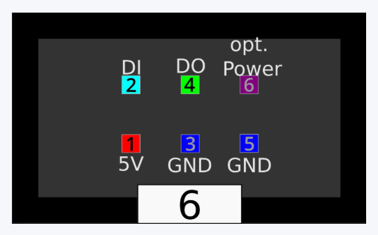

That helps a bit, but I need a different pin order. Is it possible to adjust that as well?
Hi Norbert,
I extracted the part and tried to change the PINs.
Steckverbinder 6 pin.fzpz (6.0 KB)
Regards, Harald!
That’s exactly what I was looking for.
