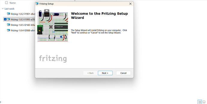

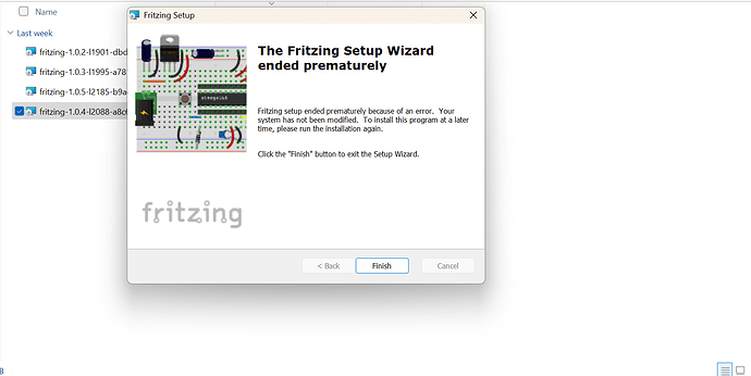

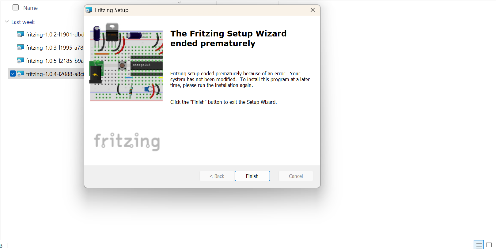

Actually a very strange situation. I keep an archive of installation files. With Fritzing 10.5 installed, my 1.0.4 install got wiped out from my computer. When I reinstall 1.0.4 it complains:

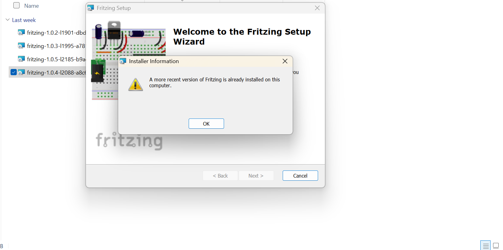

and pressing OK gets this:

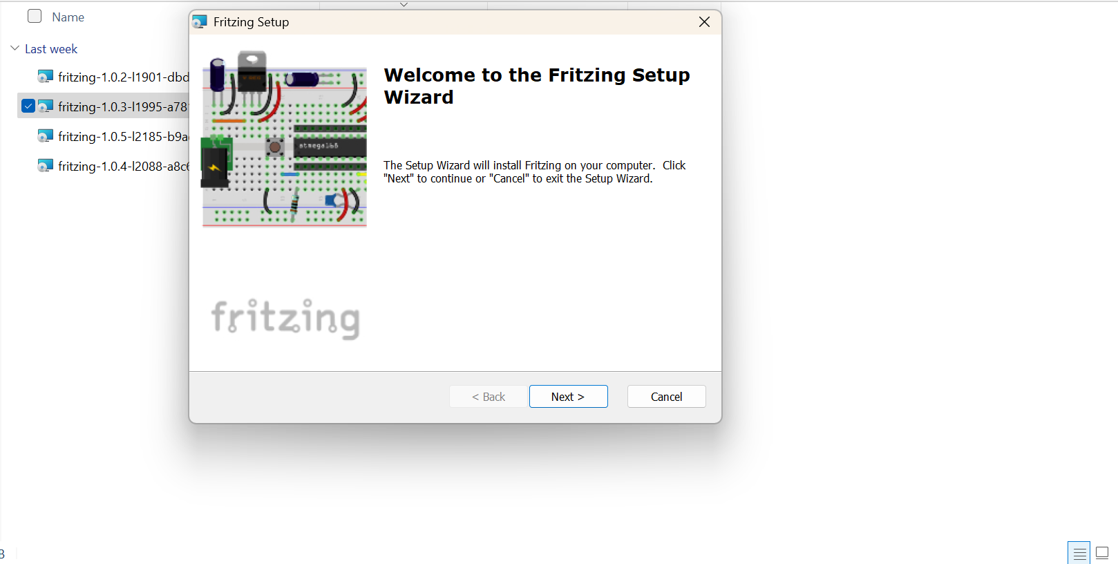

Unexpectedly, running the 1.0.3 installation is fine
but my 0.9.10 install gets wiped out. However, it looks like my COM hasn’t run out of space yet – 48GB remaining
Assuming windows (which this probably is as it is the only one with the installer) you typically need to copy the install directory to a new location and then unintall the current Fritzing version so the registry gets updated about the install before installing a new version. I expect the registry is getting confused about which version are present here (and/or there are installer bugs of course!)
The flag I showed is used at run time. It does not affect the install, and is not affected by the install (other than possibly whether the flag works for the used version). The install location is separate from the library location.
As well as moving the installed image itself, if you want to maintain separate parts libraries, you need to move that too. The full process would be: Install Fritzing version, move Fritzing executable, move parts library folder, run Fritzing from the moved location with the flag to point at the moved library. Then repeat for the next version.
