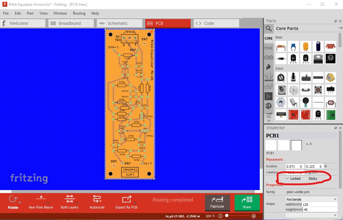

Well, it was over 1 year ago that I was stumbling across this problem and it
was solved then. But now it happens that I again want to rotate the whole pcb 180 degrees. Tried to execute the above mentioned advice but failed.
When I now select the pcb and try to tick Sticky in the inspector, that area in the inspector turns blank. Nothing to select possible.
What am I doing wrong?

This is what I see when executing the suggestions:
First I select for instance the boarder:
Then, after selecting all, this is what the inspector shows: blank.
Ctrl-R or Ctrl-Shift-R does not give any effect.

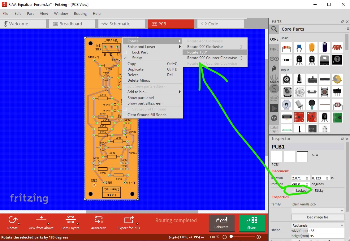

On 0.9.6 and 0.9.9 under Win10 I need to select the very edge of the pcb to get pcb (rather than ground fill) with locked set neither rotate nor cntrl-shift-r rotate the image. Note that the single / double sided field in Inspector is blanked out which it shouldn’t be.
but unselect locked and cntrl-shift-R (or left click rotate) work both work
The blank Inspector panel I suspect is caused by losing the select. I need to have the cursor on the grey line just above the ground fill in order to select pcb, it blanks the Inspector field if that isn’t true.
These are from 0.9.9, but 0.9.6 acts the same.

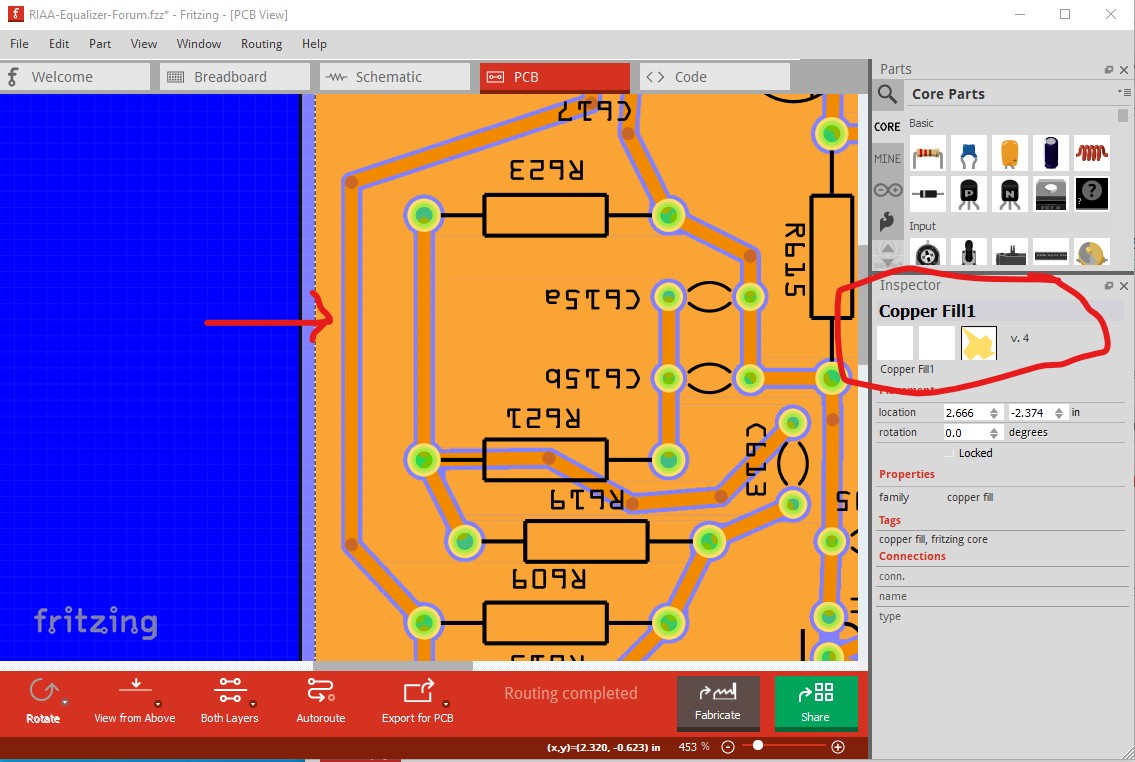

I think you understand me, your system seems to be running differently though. This set is 0.9.6 on Win 10. If I select the grey edge (the image capture loses the cursor) shown by the green arrow I get pcb1 selected in Inspector and if it is not locked I can rotate it(and I’d expect you should be able to as well!) How are you doing “select all”? For me just clicking on the grey edge selects pcb1 and that should do what you need.
If I select in a little further on the copper fill, I select the copper fill and can’t rotate it.

Ah! This explains it. We are doing the same thing in different ways and getting different results (which may indicate bugs!) Here, on 0.9.6 I did what you did and used Edit->Select all. Inspector is blanked although everything appears to be selected (I expect this is a bug as I think Inspector should be active with pcb1 selected as happens with the cursor!)
if I click on the edge of the pcb to select pcb1 Inspector becomes active but with the part locked but not sticky (which may be important!)
so change to not locked and sticky on pcb1 and see if anything changes. Nope can’t rotate the pcb either via the rotate icon or cntrl-r. However clicking on the edge of the pcb to select it with the mouse allows rotation either by the rotate icon in the tool bar or right clicking on pcb and selecting rotate in the drop down menu (which is what I was doing) so it looks like the problem (if there is one, this may be expected behaviour for some reason!) is the Edit->Select All doesn’t select in a way that allows rotation. It looks like it may be the copper fill which is the issue. If make a sketch without copper fill, edit select all appears to work:
Then edit select all and click the rotate tool bar icon and the image rotates as expected:
even though Inspector is blank, so I would guess the copper fill is affecting the rotation for some reason. Fritzing 0.9.9 appears to react the same, it won’t rotate the .fzz with copper fill, but will rotate to resistors without the copper fill (or possibly some other characteristic!)
