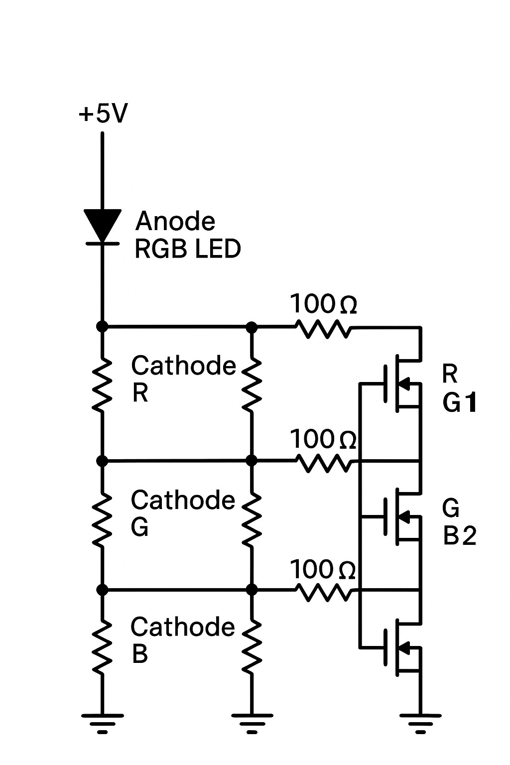

i need help in bulding this small circuit the truth is i cant read schematics(yet) so can anyone that can read this help me?
  • 3 × P-channel logic-level MOSFETs (examples: IRLML6402, SI2301P, AOZ8807P, etc.)
  • 3 × 220 Ω resistors (in series with the LED channels)
  • 3 × 100 Ω resistors (in series with MOSFET gates – optional but recommended)
  • 3 × 10 kΩ pull-up resistors (each gate pulled up to +5 V)
  • LED common cathode → GND
  • +5V (Pololu / Arduino 5V)
    |R220|R220|R220| ← series resistors for each LED color
    AnodeR AnodeG AnodeB
    DRAIN DRAIN DRAIN ← P-MOSFET (P-channel)
    MOSFET MOSFET MOSFET
    (P) (P) (P)
    SOURCE SOURCE SOURCE
    +5V +5V +5V
Common cathode (LED) → GND
Gate connections:
Arduino D9 —[100Ω]— Gate R —|| 10kΩ pull-up ||— +5V
Arduino D10 —[100Ω]— Gate G —|| 10kΩ pull-up ||— +5V
Arduino D11 —[100Ω]— Gate B —|| 10kΩ pull-up ||— +5V

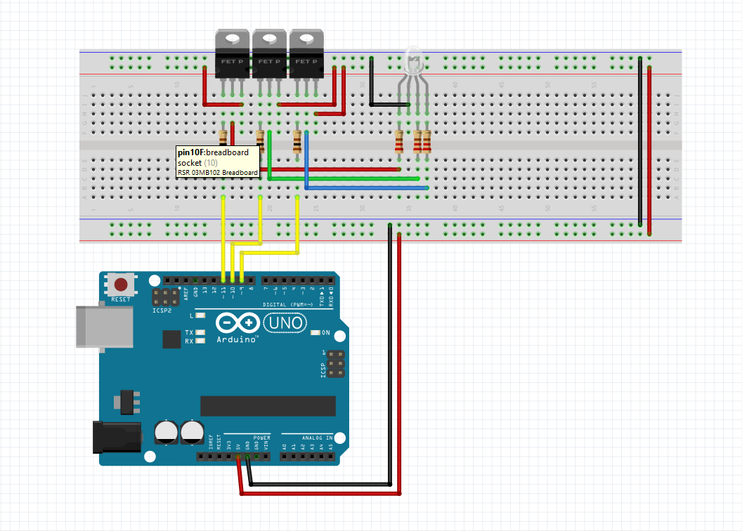

@franiuxd12 O I can help you create a breadboard circuit
@franiuxd12
RGB-LED-MOSFET.fzz (42.4 KB)
thank you! you really helped me but it shows im missing a part
Exactly which part are you missing and what is your Fritzing version @franiuxd12
the rgb but could u send me just screenshot of the file?
@ RAPTOR7762
i think i figured it out btw thank you very much
Oh ok. Do let me know if you have any problems. :slight_smile:
This circuit generated by Chatgpt has an error, just like many of the others it creates.
