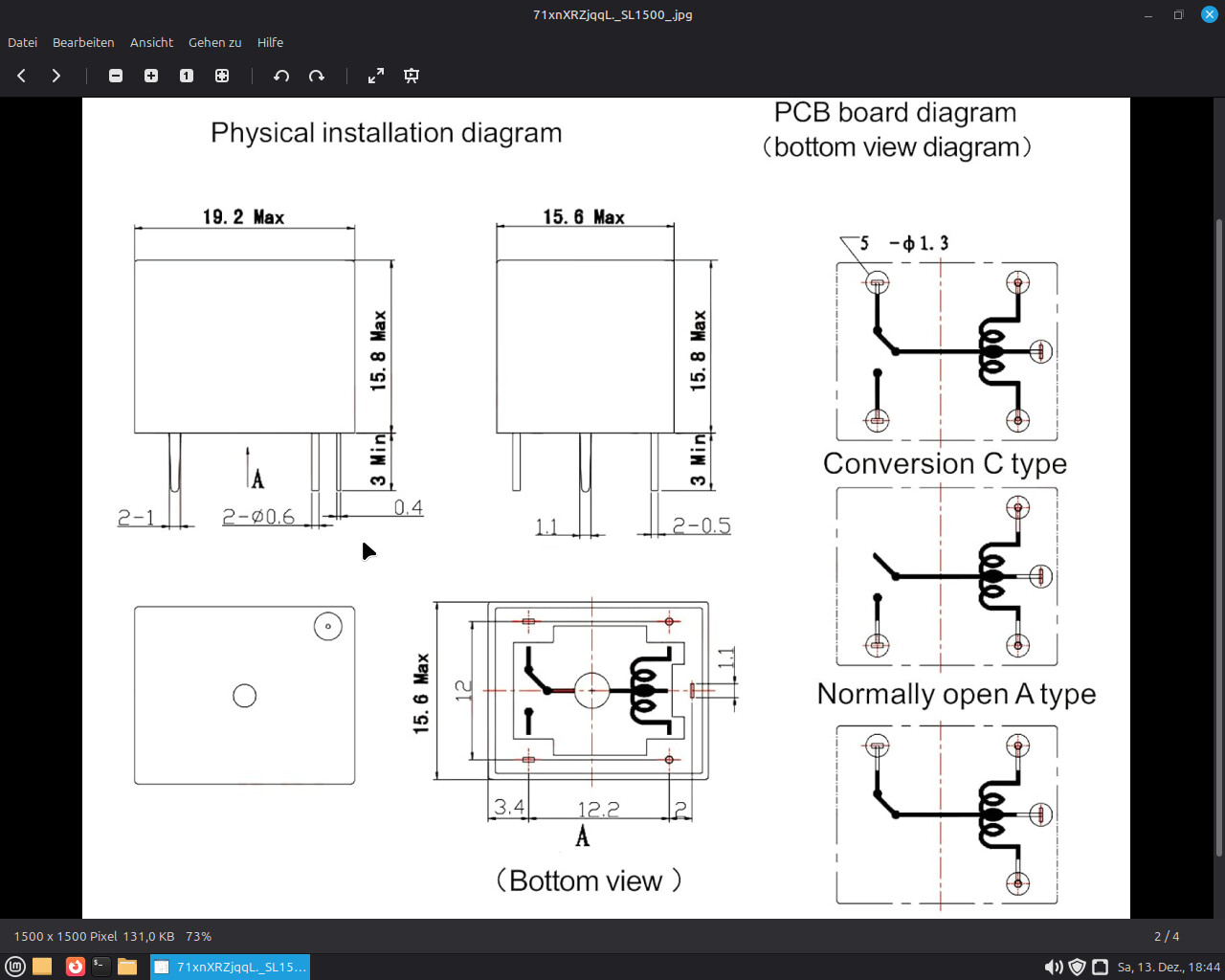

Das Relay sitzt auf den Relay Platinen, das Benötige ich Einzeln ginge so was?

Which version do you want (SPDT C type, NO A type or the unnamed NC part?) and what is the relay’s part number (so I know what to call the part)?
wenn es ginge den Conversion C Type mit 5 Anschlüssen dann habe ich an Relays Freie Auswahl.
Ich will mir die Module selber bauen die Org. sind mir zu Groß

This (from, a google image search for your drawing) to be a Songle Relay SRU-05VDC-SL-C, 5V DC/250V AC 10A which has an existing part here:

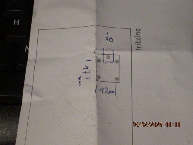

Good evening, Peter,
I just had a moment to test your component.
So the whole thing isn’t quite conclusive…
I would need a part number and preferably a web site where it can be bought as that would be a new part not the listed Songle relay.
