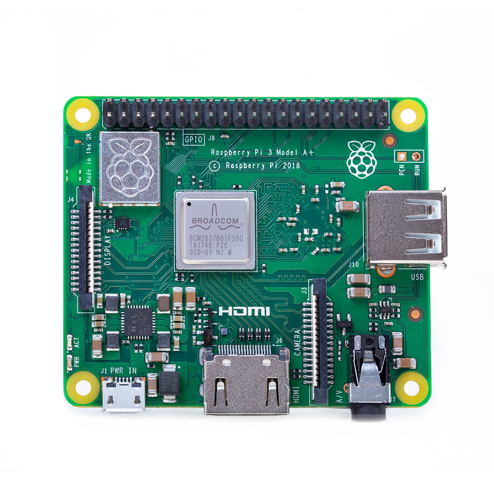

This part should do what you want. Note the mounting holes in pcb are not drilled by default. If you want the mounting holes you need to drag core parts–>pcb→hole in to your sketch, place it over each of the mounting holes on the silkscreen then use Inspector to set the appropriate hole size.
Raspberry_Pi_3_Model_A+.fzpz (53.3 KB)
