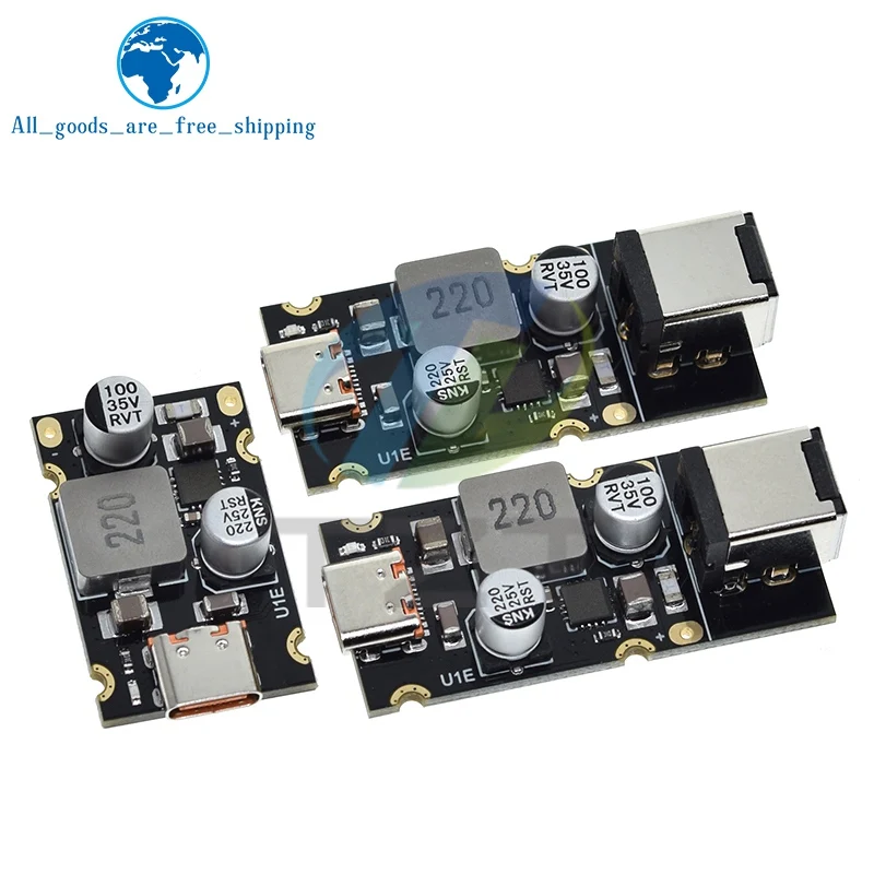

Can anyone help me with this part ?
Kind,
Dacian
It looks easy enough to do, which of the two do you want (two seem to have different size barrel jacks as input and the third has pads for input power?)
Version 31.80 mm x 20.00 mm
This part should do what you want. Note pcb only contains the input pads, and the mounting holes are by default not drilled. If you want mounting holes you need to drag a hole in to the sketch, set the size appropriately then drag it on top of the mounting holes in silkscreen.
cks-pd65W.fzpz (11.7 KB)
