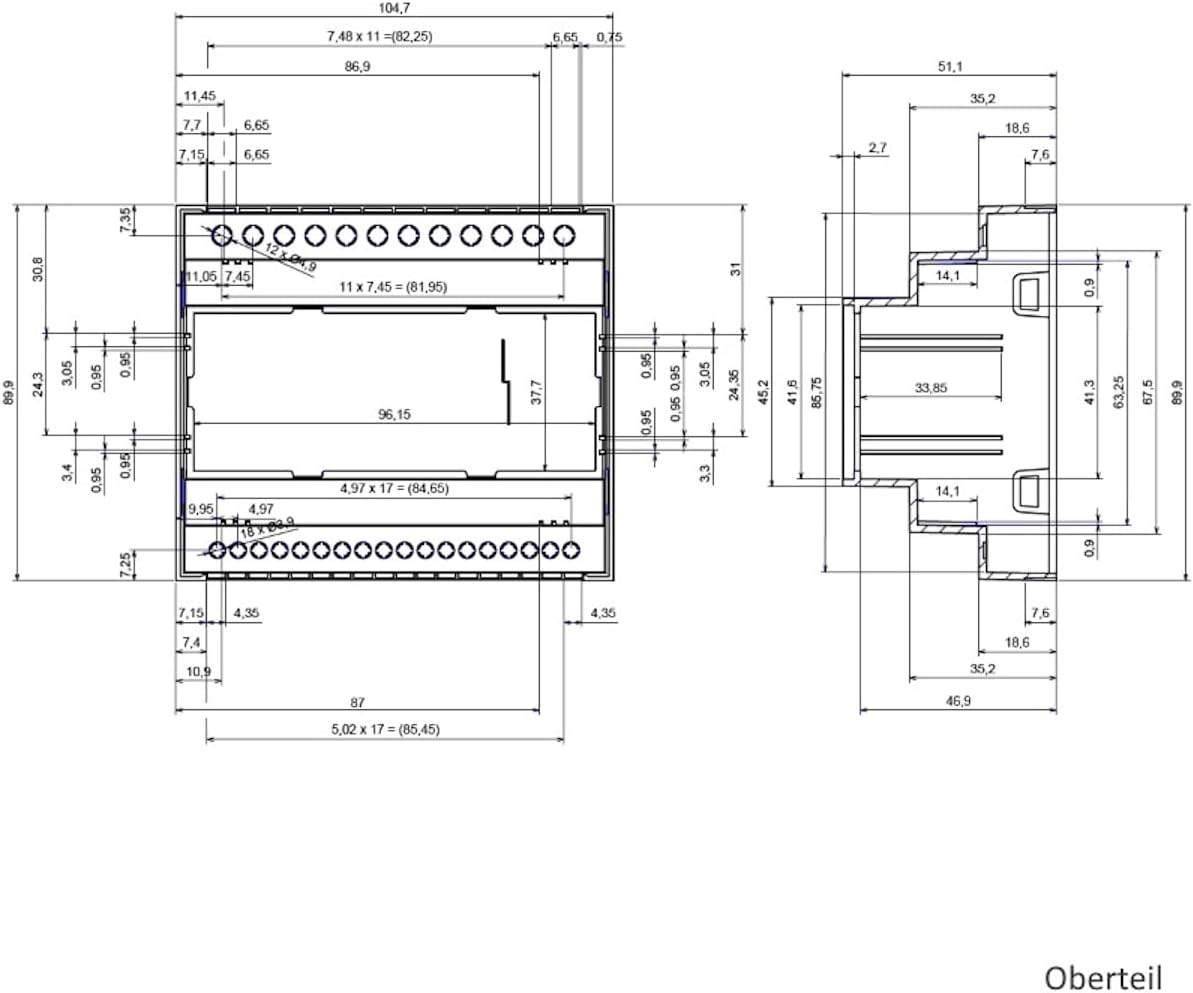

I want to build a PLC system with a few ESP 32s over Modbus .
all the documentation, motor controls, etc. is there; what’s still missing are the PCBs

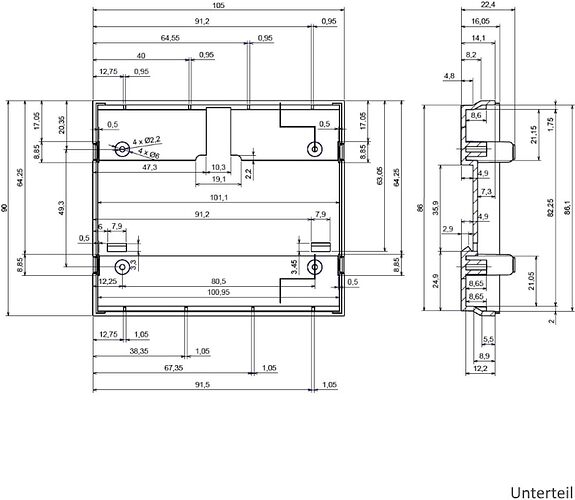

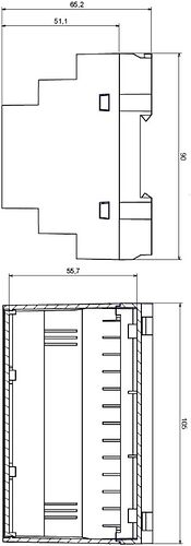

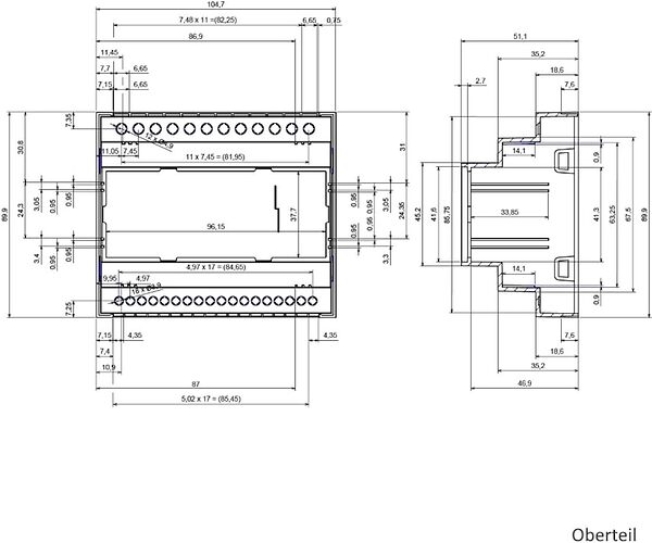

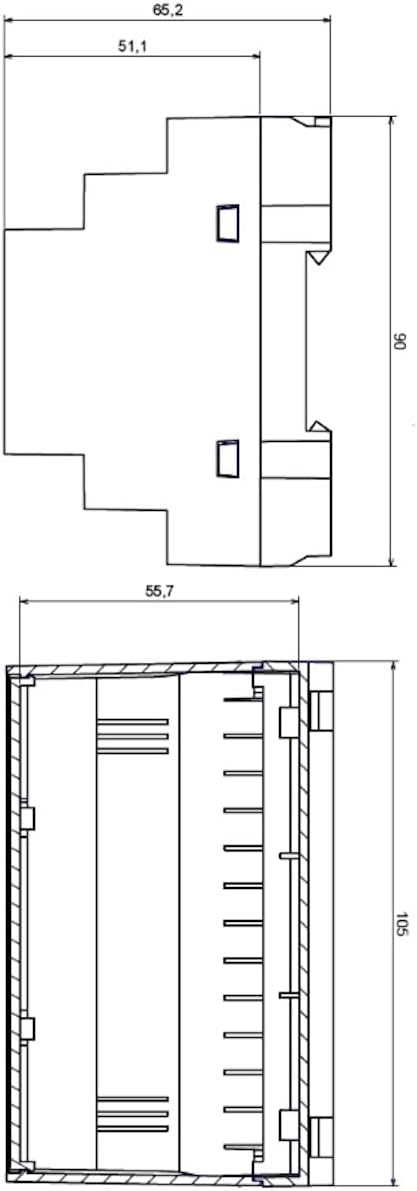

This would be the 6 TE enclosure:

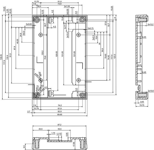

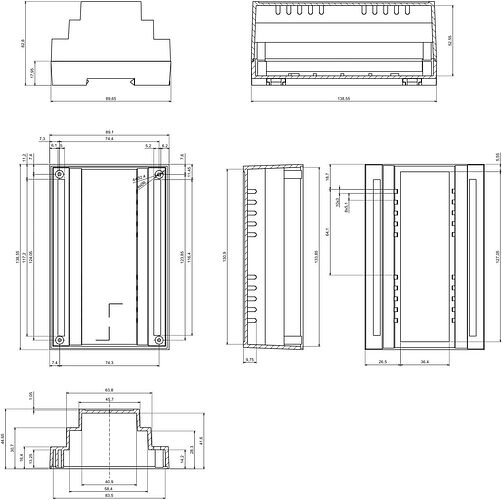

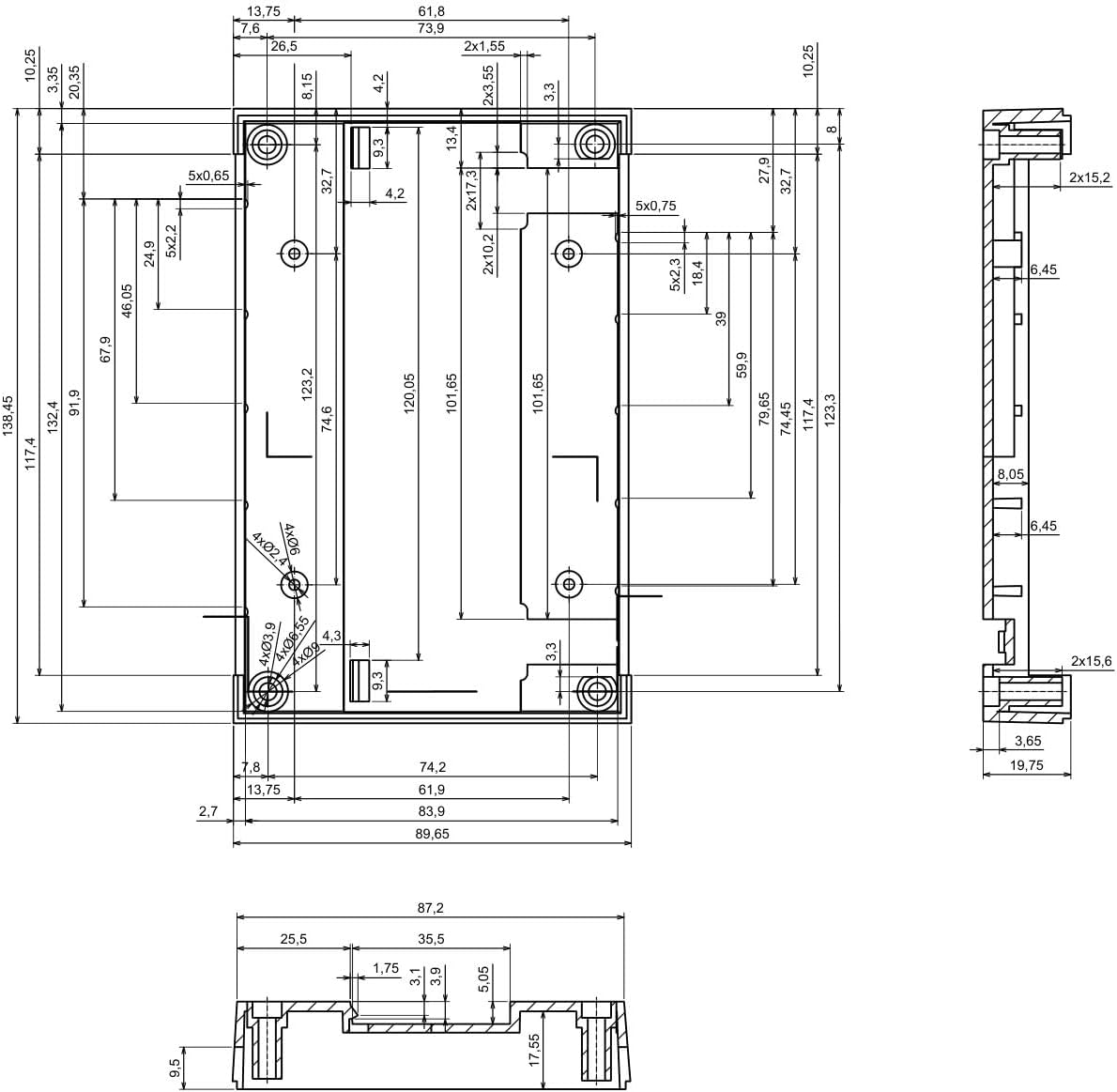

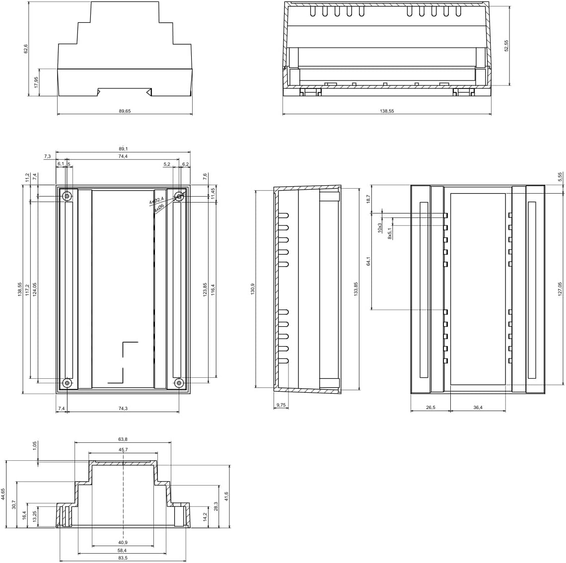

This would be the 8 TE enclosure:
It would be great if someone could help me and say beforehand whether it’s feasible.
