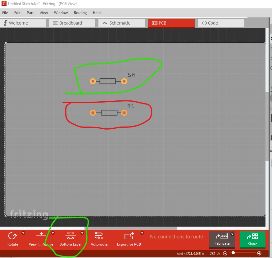

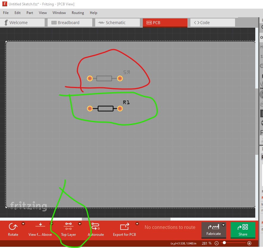

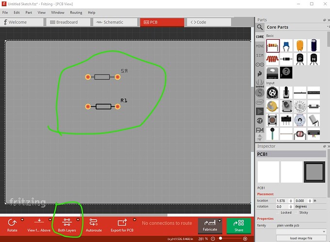

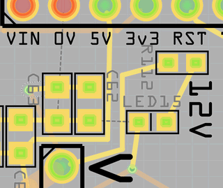

This (and related) issues have been mentioned before, but as I am on a complex project, the multiple unexpected changes are frustrating. Examples are the PCB randomly reverting from 2-sided to 1-sided, for no known reason upon saving. Another is the PCB part labels becoming grayed and non-selectable. The parts were fine, but no changes to “bring forward” or access from the bottom helped to select the labels.

Insufficient information to do anything with. Upload the sketch (the .fzz file, upload is 7th icon from the left in the reply menu) so we can try it and see what happens. What Fritzing version you are using (Fritzing 1.0.5 is the latest version) would also be useful. The greyed out labels may be from the layer settings.
