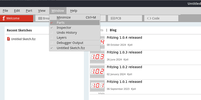

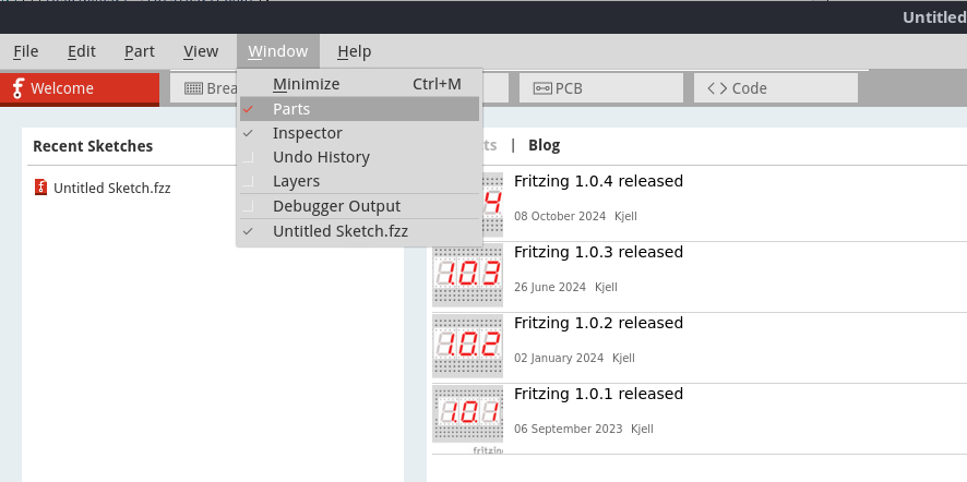

The first and most simple check should be to see if the widget has been closed.
You can see this in the “Window” menu, and also open the Parts widget there again.
If there is no hook :heavy_check_mark: next to the entry in the windows menu, the widget is currently closed.
PS. I know the original post asked about a situation where the parts widget doesn’t show, despite it is active in the Window menu. Just wanted to add this note, to avoid someone starting deleting files in case the widget was simply closed.
