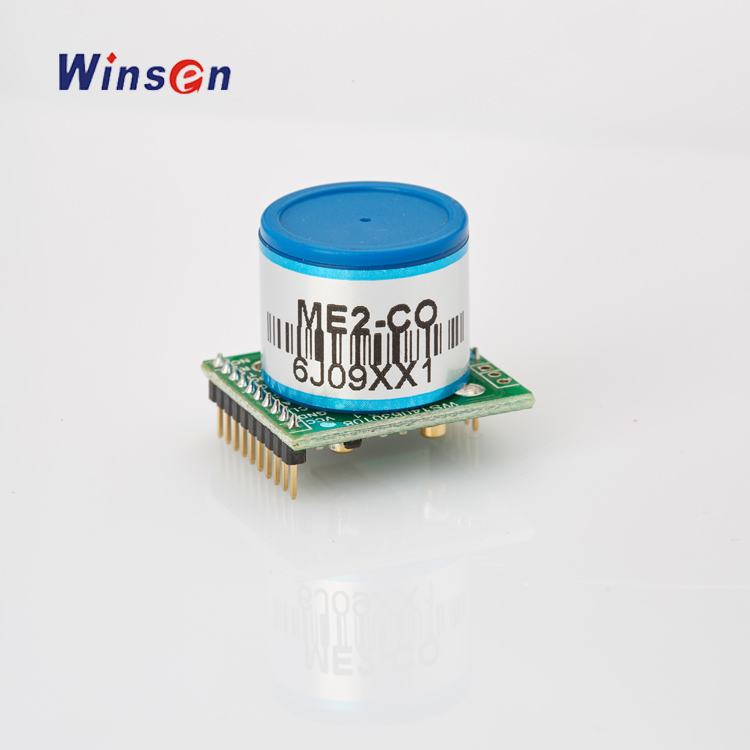

Electrochemical CO Sensor Module
Other (Carbon monoxyde sensor)
Thank you
Thank you
This part should do what you want. Before ordering boards print the pcb footprint out at 1:1 scale and compare it to a real board. The holes are set for 2mm header, but the left pins are offset slightly in y from the right pins (which seems incorrect to me.) but that is what the data sheet says.
ZE07-CO.fzpz (4.9 KB)
Thank you very much
