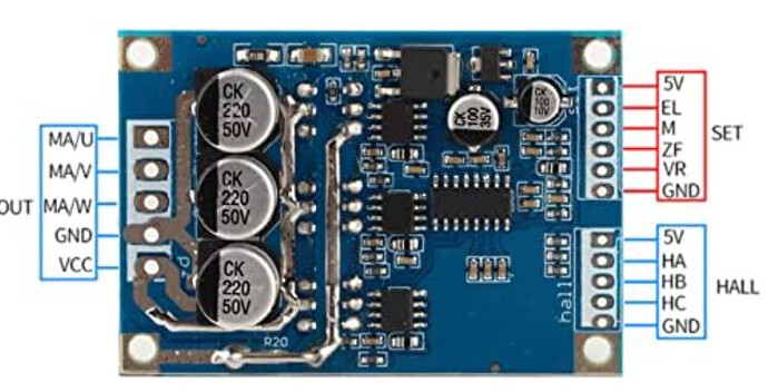

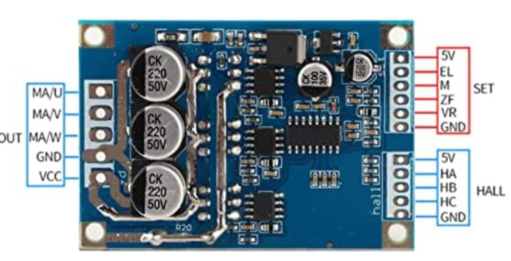

Part request: please could someone make this driver for me
Please could someone make this part for me, struggling to find it online. Thanks!
DC 12V-36V 15A 500W Brushless Motor Controller, DC Motor Speed Controller, Hall BLDC Control Board, Brushless Motor Regulator, and Stable Performance
Link
This part should do what you want. Note that by default the mounting holes are not drilled. If you want them in your sketch you need to drag the core parts→pcb→hole part in to the sketch, place it over the hole in silkscreen and set the hole size appropriately in Inspector. As well it would be wise before ordering boards to print the pcb footprint out at 1:1 scale (the default) and compare it to a real board as the part was made from a scaled jpeg image not an engineering drawing (as there doesn’t appear to be one!)
