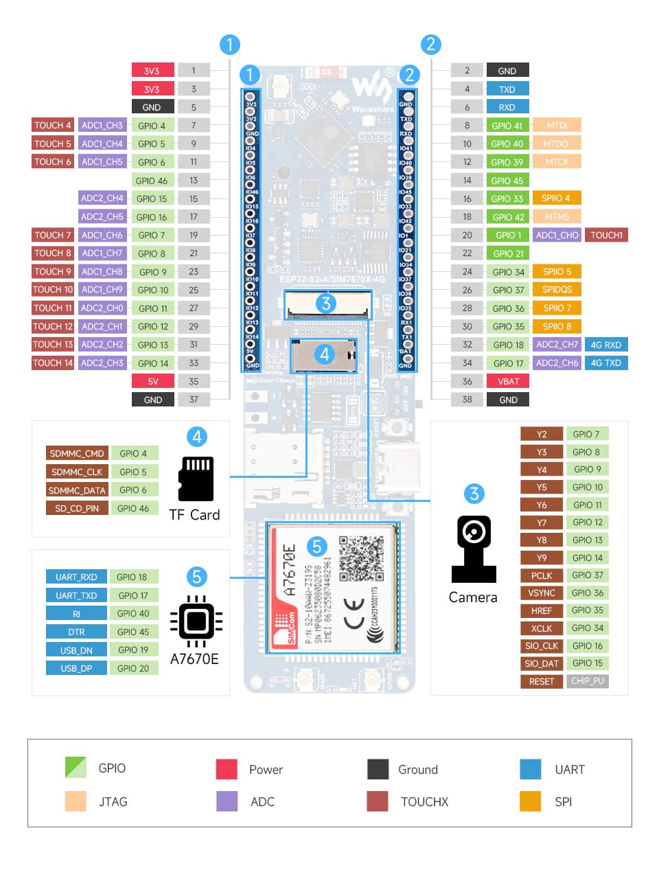

Hi, does anyone have this part? Can I get a copy please. Thank you!
I am working on a part, will be up in a while.
This part should do what you want. The speaker pins don’t appear in pcb as they are on a connector and won’t connect as well the mounting holes are not drilled by default. If you need the mounting holes you need to drag the hole icon from the pcb area of core parts in to your sketch, place it over the hole in silkscreen and set the size appropriately.
