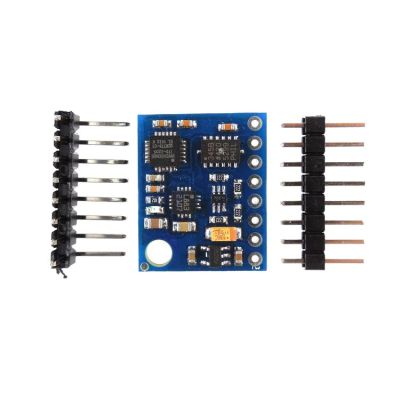

If the accelerometer can include HW-579, fine. It’s a more comprehensive sensor.
Ekran görüntüsü 2025-03-25 004458
This part looks like it should be what you want.
I’ll let you figure out how to connect it in your sketch as I don’t know where it needs to connect to do what you want. If you post your sketch I will look it over.
SBecause I don’t know the pins of the module you sent
, let’s use MPU6050, something standard will suffice.
It is the same as the module you supplied the data sheet for I expect, they appear to be the same board.
There are several of these available though such as this one
A google search of the form “fritzing part MPU6050” will turn up others as well if that doesn’t suit.
I think it’s over after changing the accelerometer last time. Thank you for everything, you’re the man.
