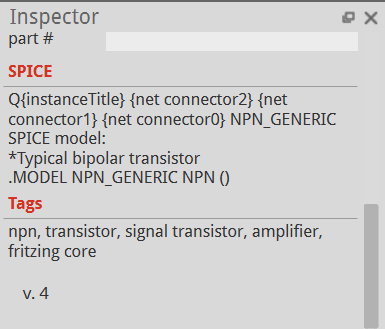

There is a sim bin
And only parts with spice info
will get simulated. Otherwise, they will be greyed out (As in this case the reed switch)
You can change the state of pushbuttons (through the Inspector), Resistance of Resistors, and a lot more.
