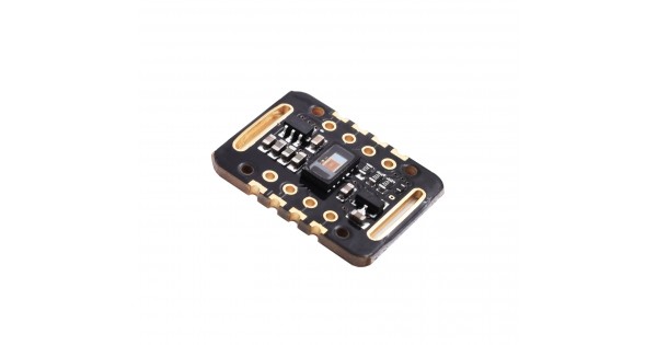

@vanepp sir I’m looking for the attached component can you please help me with this one.
datasheet and all details are attached. Actually I need this 3 components on urgent basis for major project synopsis.
Thank you.
@vanepp 3. MAX30102 (not the one which is already available on forum)
These 3 parts should do what you want.
NEO-6M_GPS_Module_with_ant.fzpz (34.5 KB)
ADPS9960_breakout.fzpz (6.1 KB)
MAX30102-breakout.fzpz (8.7 KB)
On this one check that the pin labels are correct. The part is poorly documented and the labels may therefore be in the wrong order.
ohkay noted thank you!
