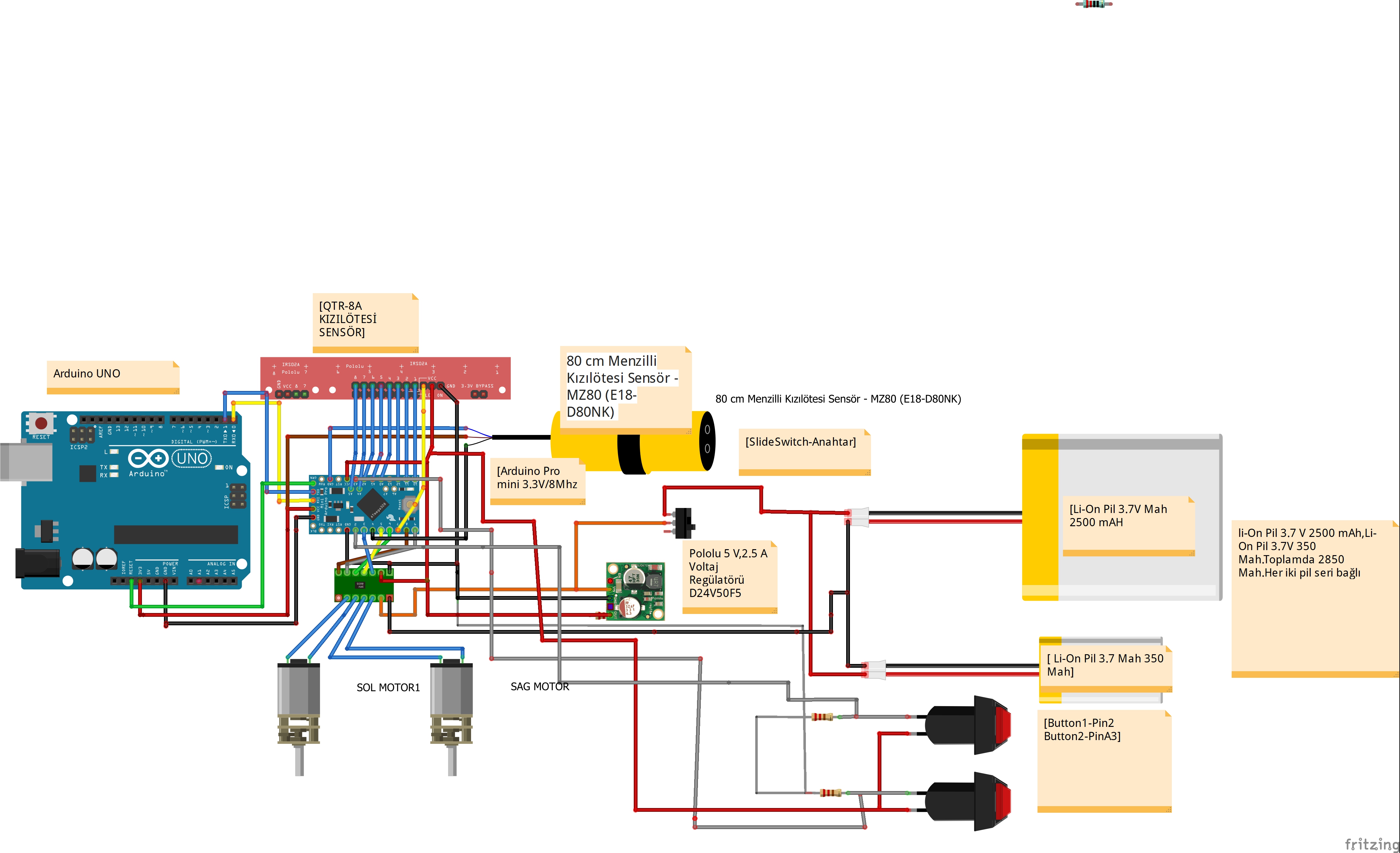

BU DEVRE HIZLI ÇİZGİ İZLEYEN İÇİN ŞEYİ SORUCAKTIM.BUNDA İKİ ARI BUTON KULLANMAMIZIN SEBEBİ NEDİR.YARDIMCI OLABİLİRMİSİNİZ.

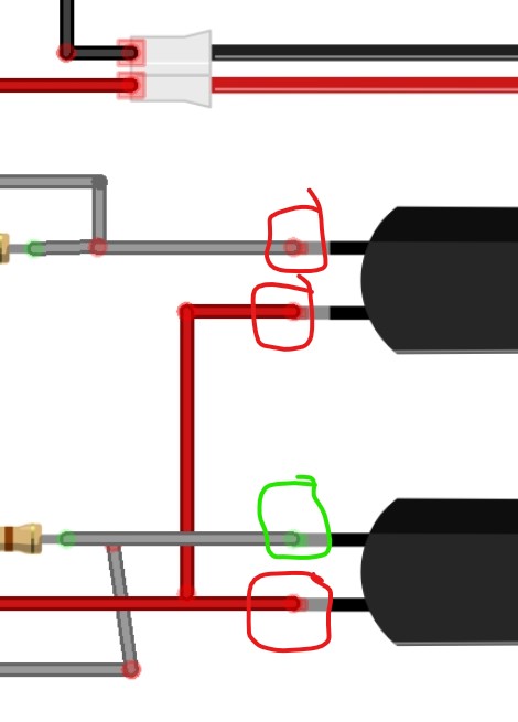

While google translate has problems with this (the translation doesn’t make much sense!) The question seems to be about the two buttons. In this image (uploading the sketch it came from is a much better choice!) only one of the wires is connected (circled in green in this image) the other 3 have no connection (circled in red) and thus neither button will do anything. If you are asking what is the purpose of the buttons, that depends on the software (and thus we have no way of knowing.)

Peki o iki buton yerine tek butom kullansak nasıl olur.
peki bu şekilde tek butonlu olarak çalışır mı peki .yardımcı olabilirmisiniz.
peki tek butonun uçlarına direnci kaldırsak nasıl olur.
[quote=“vonali55, post:4, topic:12858, full:true”]
peki tek butonun uçlarına direnci kaldırsak nasıl olur.[/quote]

As Peter said in the original answer, whether it will WORK or not depends on the what they are intended to be used for, and how the software is written. I expect that no it will not work. My guess, from almost no information, is that the buttons control the motors. Either separately, or in combinations. A program COULD use a single button to sequence between patterns, but 2 are needed to directly set both with directions.
That original image has more problems than Peter showed. There are also wires that end on top of other wires. Those are not connected either.
It seems you have some learning to do about several things. How Fritzing works, how electricity works, and how programs work.
