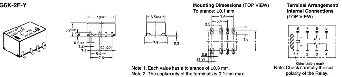

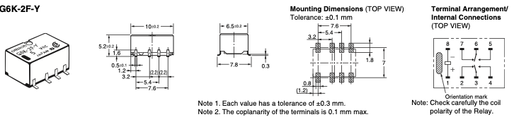

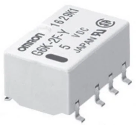

Hi.
I need a component for my DIY project which I unfortunately could not find via Google. It is a relay OMRON G6K-2F-Y-DC5V.
I would be grateful for any help.

I found that too. It is a G6K-2P-Y which is a THT part. But I am looking for the G6K-2F-Y SMD variant.
This part should do what you want. Before ordering boards print out the pcb view at 1:1 scale (the default) and compare it to a real part.
