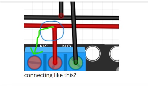

And also why aren’t two wires
connecting like this?
Because the connection will only work to a connector on the part. You need to run the wire to the connector on the part it connects to and then route it along the path of the wire like this:
You need to drag the end point of the wire to the connector that the red wire connects to.
But two wires wont connect from the middle so how do i manage it?
Like this:
Here I right clicked on one connector and Fritzing lights all points connected in yellow.
Ok. Got it Thanks for the help
